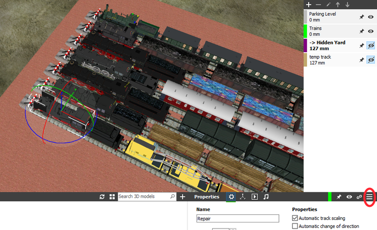

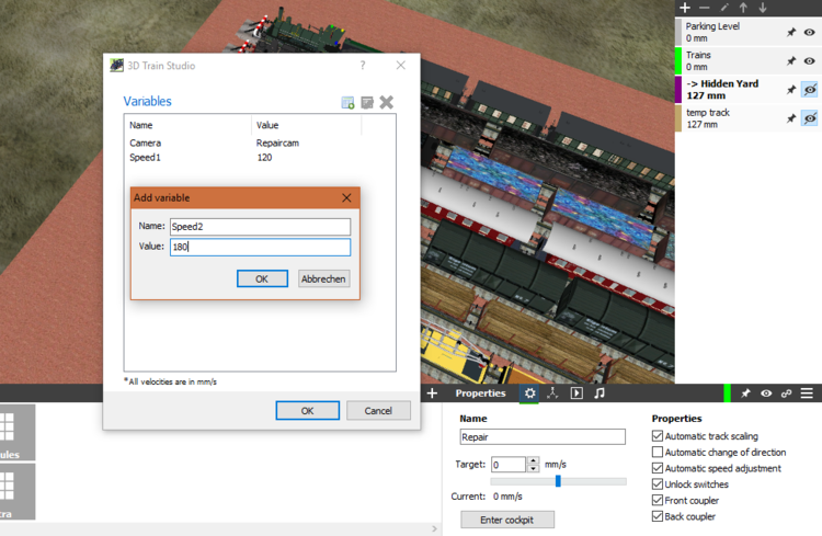

Geschrieben 5. Januar 20178 J I have found the same issue through the plug-in interface, track events can be sourced from ANY, but only ONE, of the driven locomotives and appears arbitrary and will change from track join to join. The work around to this is to add a variable to the locomotives.... something like Train_ID = 1,2,3 etc. Obviously with the same numeric value on all locomotives attached to the same train. Then in the event handler "ANY train enters/exits track".events, add a qualifier condition that filters for $Trigger_1.Train_ID. Bearbeitet 5. Januar 20178 J von trevor
