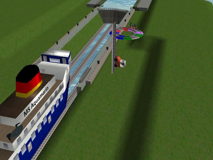

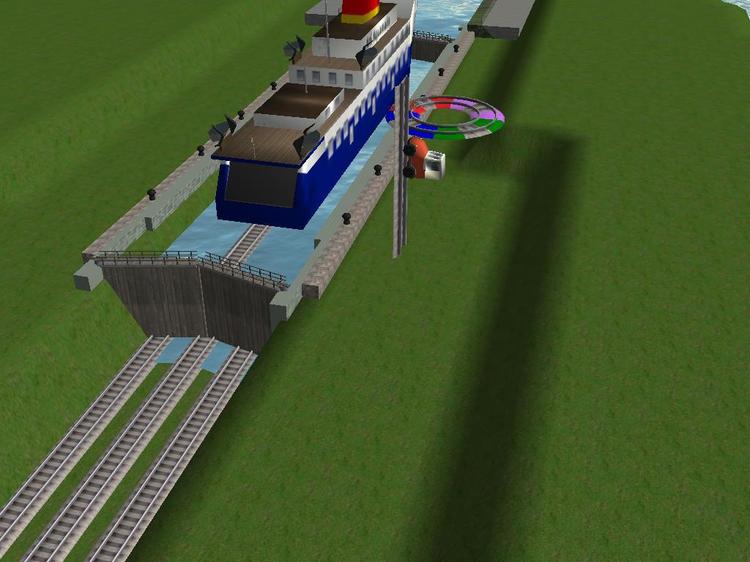

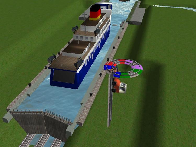

Working also on the Roof of the St James station in London and a Boatlock. (will need help on how to configure the doors to open)
I made a model with pieces from the game, to see if it was possible to lift water, the tracks and the boat. It seems to bve possible contecting the track of the ship to a dummy-lok. that dummy lok then again is placed on a vertical piece of track.

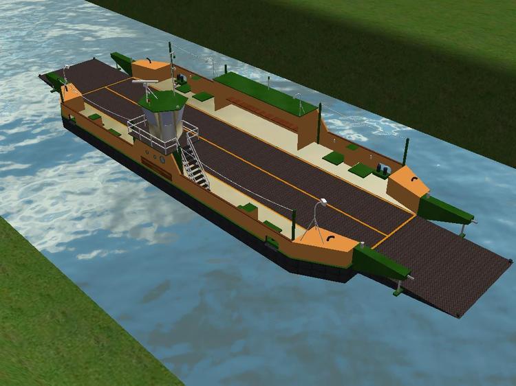

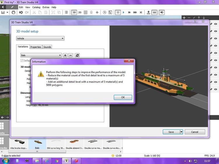

Thanks Neo !
I have allready seen some things that are wrong in the Ferry by the rules.
could you help where i should make the changes ?
The ferry is one whole group. Should i divide it ?
