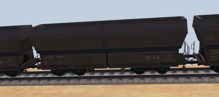

simonjackson1964 Geschrieben 5. August 2018 Autor Geschrieben 5. August 2018 And the joke is on me... I switched to using the Falns 81 80 D DB hopper wagon It's a great rendering of it, by the way! I have a train of 18 of these guys that gets hauled from a coal mind to a power station and back. So, filling at the power station, all working. I made a little rectangle of ... Well, if I was doing this for real, I would have used plasticard, so whatever the virtual equivalent of that is - painted it with coal paint (Hey, get me a can of tartan paint? No problem! Computers are the solution to old jokes!) Popped it in the wagon at the top, linked them, and then copied the wagon 17 times. The load sequence works perfectly, dropping coal into the wagon, the when that stops the coal "card" becomes visible and hey presto! The only thing was, that, as I was watching from very close to as the wagons passed beneath the camera, I spotted a dark shadow in each one. Oops, they are already loaded. Oh well, too late now. Besides, I had to look really close to realise it. And then I took the train down to the power station to unload it... So, I knew one of those two animations opened the doors at the bottom, but not speaking (or reading) German, I had no idea what the other one did.. Until I tried it. Well look at that! It empties the wagon. I still think my coal layer is more realistic, but if only I had realised this at the start I could have saved myself the trouble! Moral of the story: Always check wa=hat all the animations do before you start!

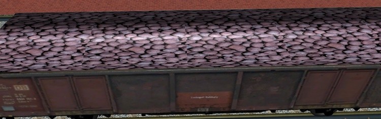

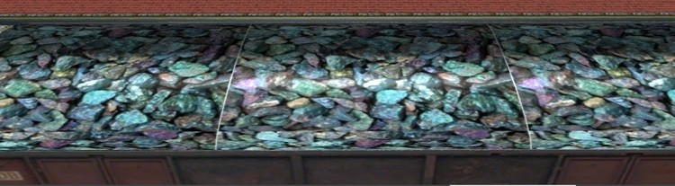

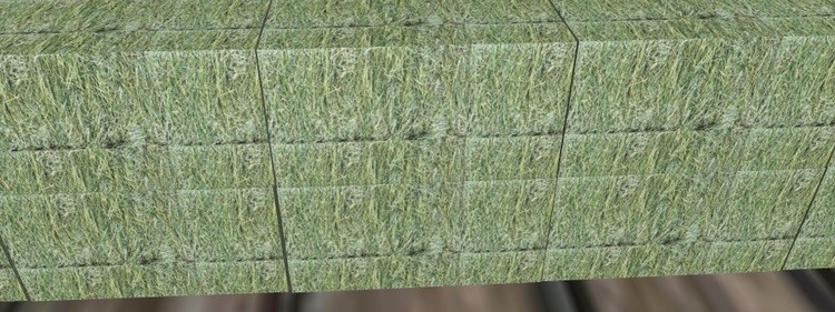

Curt84328 Geschrieben 9. Oktober 2018 Geschrieben 9. Oktober 2018 some of my custom hopper and flatbed loads
