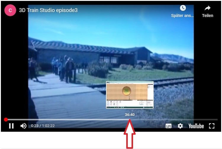

ThoLav Geschrieben 13. Januar 2021 Geschrieben 13. Januar 2021 (bearbeitet) I think it starts at 33:00 min. Bearbeitet 13. Januar 2021 von ThoLav
Eric Lord Geschrieben 13. Januar 2021 Autor Geschrieben 13. Januar 2021 Thank you for taking the trouble for finding the time for me. Eric
Goetz Geschrieben 13. Januar 2021 Geschrieben 13. Januar 2021 vor 3 Stunden schrieb Eric Lord: taking the trouble especially when you take under consideration, that all you needed to do, was: start the video place the tip of your mouse pointer over the timeline at the bottom move the mouse slowly left and right (without pressing any buttons!) observe what's shown in the small preview picture over your mouse pointer and try to figure out, if any of those small images resemble "landscaping" in any way.
Eric Lord Geschrieben 13. Januar 2021 Autor Geschrieben 13. Januar 2021 Hi Goetz, You know you look after me like my late father. I did find the place but I am more baffled than ever even after using subtitles. Do you think that it be easier for me to try and use the one which is yours even though the dialogue is in German? Arni
