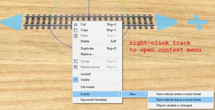

As a unit leaves a track I wish to set the vehicle speed to 95    How do I do this?
create an event that uses the Vehicle leaves a track event and have it set the speed to 95
This is generic using any vehicle, but a specific track/   It can also be just one vehicle,
Close, but no cigar, @Curt84328
You cannot assign the vehicle on track 55200 a new speed, when the vehicle has just vacated the track.
Instead, use "trigger" and then "vehicle" as the target vehicle and "All" for the track, please
Greets
Goetz
Bearbeitet von Goetz
Bild hinzugefügt
