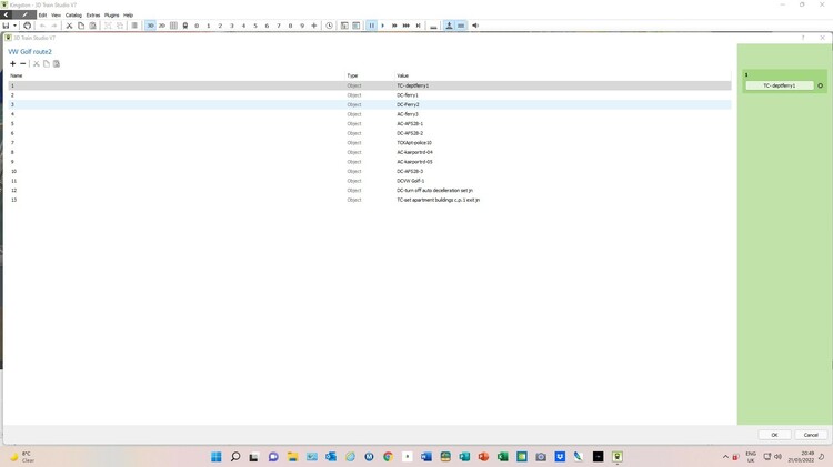

I have a number of vehicles that have their routes set individually. Most have upto 4 separate routes and all work well in themselves. However I do find that when a vehicle makes contact with the TC that will start it's particular route the vehicle will stop, sometimes only momentarily, other times for several seconds. If the latter then the whole program freezes and is only unfrozen when that particular vehicle actually starts its designated route. This is most apparent when there are 7 or more instructions within the route. Many of the "objects" set are used by other vehicles as well but I cannot believe this would cause the problem.
Is this a normal phenomena or is there a way to resolve it. As things stand at the moment when this freezing occurs it can sometimes adversely affect other vehicles and their routes depending upon the intricacy of said vehicles movements at that time. Currently I have in excess of 40 vehicles on this particular layout so things need to work perfectly.
I have attached a screenshot of one of the vehicle routes in question.
All advice gratefully received.
Pete
If the whole Program freezes, then you like have a Endlessloop in your EV.
Hi Sintbert
Thanks for that although at this moment in time I'm not too sure how to investigate this. The problem is worst with one particular vehicle, the VW Golf in the screenshot as it starts route 2. The whole program freezes for about 15 seconds. With others it is no more than either 1 or 2 seconds at best or 5 seconds at worst.
How do I start to investigate an endless loop?
Pete
Hello Pete,
vor einer Stunde schrieb 220hotwheels:
I experience the same here just now, as it happens.
When I pass a list of targets to a vehicle, the calculating time for the route increases exponantially with the number of targets in the list.
The workload for the route finder increases exponantially, because the possibilities do too with each additional step.
My conclusion: When dynamic route assignment is desired, it's advisable to only assign the next target ahead at each waypoint.
When the entire route is fixed (e.g. a bus route), you may assign that route once only, maybe at the start of the program.
vor 14 Minuten schrieb 220hotwheels:
Open and observe the event trace window.
Greets
Goetz

Many thanks for your advice. In a way it's good to know that you too have experienced this problem. Most of the vehicles designated specific routes have their overall route already split into either 4 or 5 sections because of the specific need for direction change at the older style junctions. However within each of these separate routes there are as many as 13 different waypoints listed and some of those waypoints are also included in other vehicle route listings.
So I will follow your recommendation for this particular vehicle initially and introduce 4 separate routes (reducing the number of waypoint in each) to replace the one 'route2' for this VW Golf and see if that sorts out the problem. If it does then I can adopt the same solution to any others.
I'll let you know the outcome either way.
Cheers
Pete
Hi Goetz
Well, your suggestion has worked just fine. Part one of route 2 with only 3 waypoints and the little VW Golf stops only momentarily before going on it's merry way. So lots to do now to improve other hiccups but at least the little grey cells have gained yet more knowledge, with yet another problem solved, in what seems to be a merry go round of problems and solutions. Life's never dull with 3D Train Studio and would we want it any other way?
Cheers
Pete

Having applied your recommendation to most routes then the program lag has drastically reduced as the route finder has less work to do before confirming the assigned route. My current problem is perhaps the number of individual routes applied to my present layout. 1.5 seconds seems to be the longest lag caused to the movement of  most items but even so this can throw some element out of sync especially if there are several such lags within a short period of time and such lags happen whilst a vehicle is negotiating a junction with traffic lights or something similar.
Clearly this problem only appears to apply to specific routes applied to a particular vehicle, I currently have over 30 such routes, these being essential when a particular route involves specific junction changes/portals or reverse directions. For those routes set as a single round trip route then there does not appear to be any issue. In your opinion is there anything further that you feel I might be able to do to reduce this problem. I've read your conversations with Herman but my problem is that nothing is currently able to share the same route fully. If there is nothing further that I am able to do then do you feel that a future update might possibly address this issue, or am I just clutching at straws?
Perhaps it's time to get back to the drawing board rather than maintaining an optimistic view that all will come right in the end!!!
Kind regards
Pete
vor 25 Minuten schrieb 220hotwheels:
You may give each vehicle a single target only and then assign the next one upon arrival at this destination.

I don't know about "Deep Blue" more like egg on face and a winding handle. All of that said, thanks to Goetz and a bit of a rethink today plus quite a bit of a reshuffle and so far, fingers crossed, no further problems with lag as each vehicle moves from one set route to another. Tomorrow I'll try a complete run through just to be satisfied.
Pete
Perhaps   ;)
Hi Goetz
Having followed your advice more closely with a few modifications to the layout it would seem that the lag issue is all but gone now. Tomorrow I will try a full run through so fingers crossed all will be well.
Many thanks for the continued patience and advice.
Kind regards
Pete
