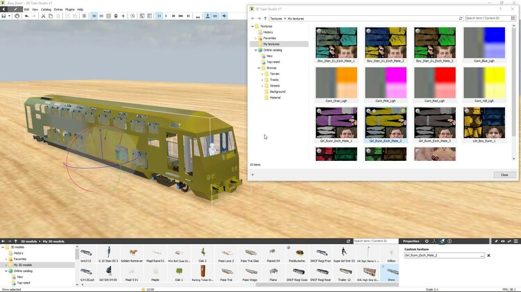

Dad3353 Geschrieben 13. Juni 2022 Geschrieben 13. Juni 2022 51 minutes ago, BahnLand said: ...It is not possible to simply store additional files that were created in the MBS on another PC in the catalog of the Modellbahn-Studio (MBS) stored on the local PC so that they can then be automatically recognized by the MBS of the receiving PC... I'm sorry, but I don't understand. I can create a New texture, using any 'power of two' picture, and save it to 'My Textures' in MBS. I can then apply this texture to any model accepting 'Custom' textures, and the image is applied to the model. When I save that model, its texture is retained. Here's one I've just done, just to make sure it works. What have I mis-understood..? Es tut mir leid, aber ich verstehe nicht. Ich kann eine neue Textur erstellen, indem ich ein beliebiges „Zweierpotenz“-Bild verwende und es in „Meine Texturen“ in MBS speichere. Ich kann diese Textur dann auf jedes Modell anwenden, das „benutzerdefinierte“ Texturen akzeptiert, und das Bild wird auf das Modell angewendet. Wenn ich dieses Modell speichere, bleibt seine Textur erhalten. Hier ist eine, die ich gerade gemacht habe, nur um sicherzustellen, dass es funktioniert. Was habe ich falsch verstanden..?

Dad3353 Geschrieben 13. Juni 2022 Geschrieben 13. Juni 2022 We may be at cross-purposes here. I was not suggesting publication, merely replying to the original question, although, if the combined item and exchange texture are then saved, they can be published together, and thus be available to others. Here is an (unfinished...) test coach, with a previously-published local test texture, published as a Draft... 9BE0CA7B-8CF0-4316-9C0C-9112C09395CE It has retained its exchange texture, but is still able to adopt another, or revert to its original livery. In the original question, there was no notion of publishing, but it can be done, if the exchange texture is published first (even as a Draft, as in this example...). Wir sind hier vielleicht aneinander vorbei. Ich habe keine Veröffentlichung vorgeschlagen, sondern nur auf die ursprüngliche Frage geantwortet, obwohl, wenn der kombinierte Artikel und die Austauschtextur dann gespeichert werden, sie zusammen veröffentlicht werden können und somit für andere verfügbar sind. Hier ist ein (unfertiger ...) Testcoach mit einer zuvor veröffentlichten lokalen Testtextur, veröffentlicht als Entwurf ... 9BE0CA7B-8CF0-4316-9C0C-9112C09395CE Es hat seine Austauschtextur beibehalten, kann aber immer noch eine andere annehmen oder zu seiner ursprünglichen Lackierung zurückkehren. In der ursprünglichen Frage gab es keinen Begriff der Veröffentlichung, aber es kann getan werden, wenn die Austauschtextur zuerst veröffentlicht wird (sogar als Entwurf, wie in diesem Beispiel ...).
