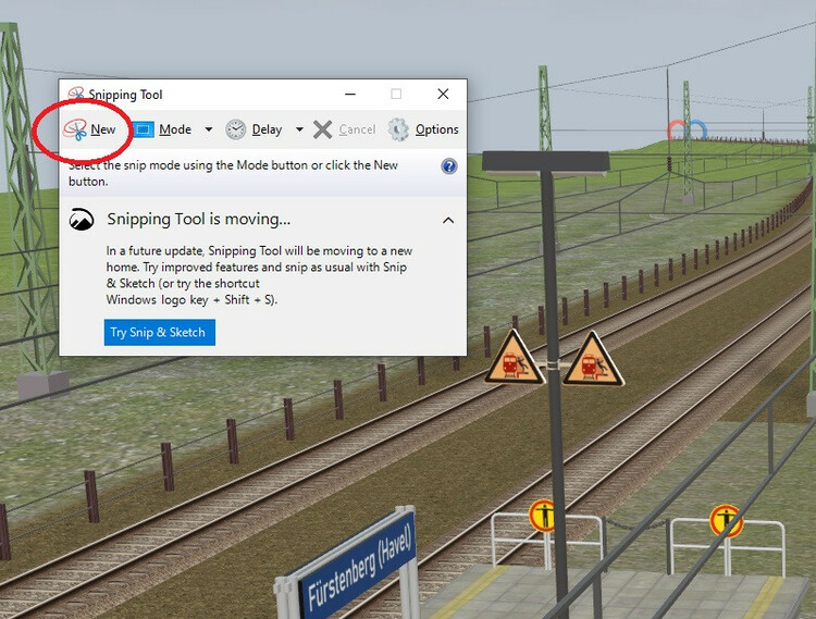

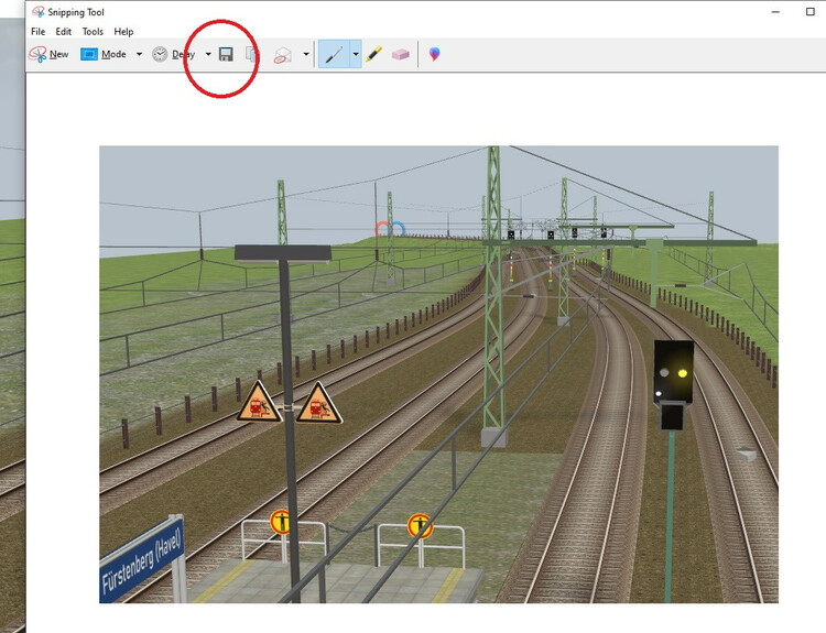

simonjackson1964 Geschrieben 7. Dezember 2022 Teilen Geschrieben 7. Dezember 2022 Best guess, your new baseboard isn't level. Assuming you are using Windows 10 or later, in the start menu, under "Windows Accessories", you should have a "Snipping Tool" - a pair of scissors overlaid on a white ellipse with a red border. This tool will allow you to "snip" a portion of your screen and save it to a file (default name is "Capture" but can be changed) Click "New", then select the area of the screen you wish to "snip" - The snipping tool automatically disappears as you do (I did these screen-shots the old fashioned way). If you miss the bit you want, just click "New" again and keep trying until you have what you want. Once you have your image: Click the save icon. Remember where you saved it and insert the image here using the attachment box below. This will make it much easier for Goetz, and te others (even me) to help figure out what is wrong. Cheers Simon Link zu diesem Kommentar Auf anderen Seiten teilen More sharing options...

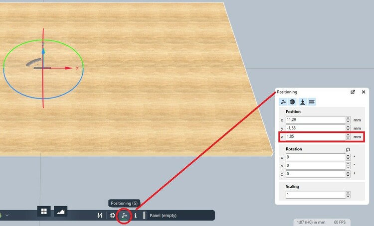

Goetz Geschrieben 8. Dezember 2022 Teilen Geschrieben 8. Dezember 2022 Hello @simonjackson1964, Eric's mishap came about the other way round. After deleting his original base panel by accident, he dragged a fresh one from the catalogue onto his layout. Which ended up being stacked on top of the tracks, due to the height adjustment settings He should have reset the base panel's z position to 0. But raising the tracks was okay too as a solution. Greets Goetz Link zu diesem Kommentar Auf anderen Seiten teilen More sharing options...
Eric Lord Geschrieben 8. Dezember 2022 Autor Teilen Geschrieben 8. Dezember 2022 Hello Goetz, After reading your reply to simonjackson1964 how about if I deleted my base again and then installed a new as before. But how do I set the zposition to 0 so this doesn't happen again or can I do this without deleting this base I have now. Thanks for any help as always. Eric Link zu diesem Kommentar Auf anderen Seiten teilen More sharing options...
Goetz Geschrieben 8. Dezember 2022 Teilen Geschrieben 8. Dezember 2022 vor 27 Minuten schrieb Eric Lord: how do I set the zposition to 0 by first selecting the base plate and then opening the "positioning" panel where you enter a 0 in the appropriate field. Please note the various labels, designed to guide you Hope this helps you to not only solve your current riddle but also understand a little better, how the user interface is struchtured? Goetz Link zu diesem Kommentar Auf anderen Seiten teilen More sharing options...
