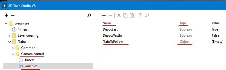

220hotwheels Geschrieben 12. August 2023 Autor Geschrieben 12. August 2023 11 hours ago, Phrontistes said: Hi Pete, That's the problem. You cannot deal with as vehicle in a virtuel depot. The vehicle-object does not longer exist once the vehicle entered the depot. Yes. In the following example I declare a modul-variable of type object named "TrainToFollow" and I store the vehicle-object of the vehicle leaving the depot west in this modul-variable for further use. You will have to deal with this in order to progress. Kind regards Phrontistes Hi Phrontistes Thank you so much for taking the trouble to reply to my enquiry. My EV knowledge is still somewhat limited but I will take more time to consider and evaluate your kind suggestion in order to see if it will help. Once again many thanks Pete
Phrontistes Geschrieben 12. August 2023 Geschrieben 12. August 2023 (bearbeitet) vor 57 Minuten schrieb 220hotwheels: find attached a screenshot of said EV Here you have a problem: This is not allowed. You may not target a vehicle object when the vehicle could be in a depot. Kind regards Phrontistes Bearbeitet 12. August 2023 von Phrontistes Amendment
220hotwheels Geschrieben 12. August 2023 Autor Geschrieben 12. August 2023 17 minutes ago, Phrontistes said: Here you have a problem: This is not allowed. You may not target a vehicle object when the vehicle could be in a depot. Kind regards Phrontistes Yes I understand that is where the problem lies I just don't know how best to solve the issue other than to allocate a separate TC for each of the trains, although I can reduce the number of TC from 6, in this instance, to probably 3 by carefully allocating batches of 2 trains to each of the 3 EV's. Even so that seems to be a bit of an amateurish solution and as there will ultimately be a total of 10 trains at least requiring to negotiate these switches I think I need to find an alternative solution. Kind regards Pete

prinz Geschrieben 12. August 2023 Geschrieben 12. August 2023 @220hotwheels , If a train is in a depot, it does not longer exist as an object. All references outside the depot were cleared and replaced by an empty object ([leer]), even in EV. But you could use the name instead the object itself (if names are unique): Change the preset "Object" in the vehicle setting by "Object (Name)". It works like you desired with the object itself and is not changed, when train is in a depot. And - by the way - you can make EV more easier, if you use the possibilities of graphical EV. Here: You defined the track contact "TC-set Pre freight terminal jn's" as trigger. Now you don't need to reselect the TC in "Track/Track contact" settings. Just change the type in "Trigger". Best regards, Wolfgang
