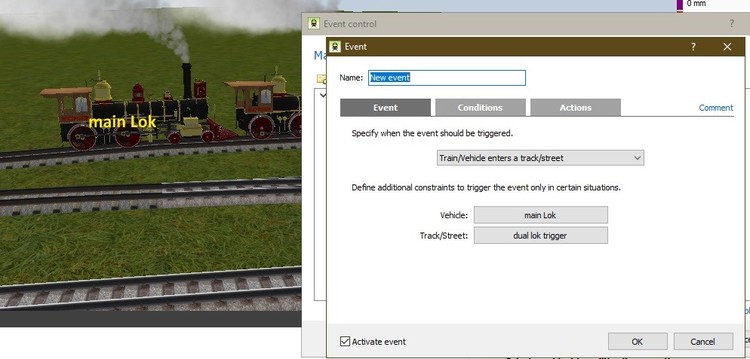

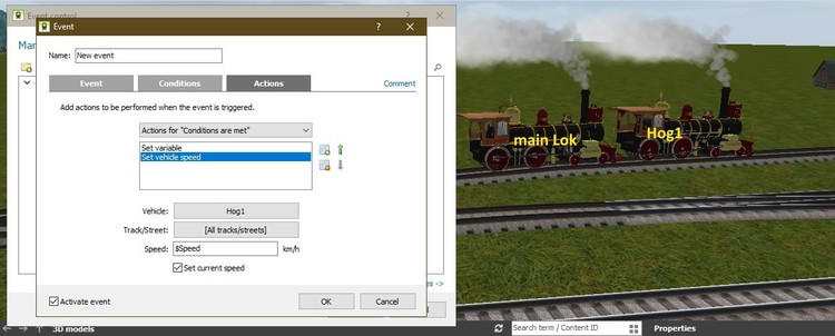

I'm still experimenting with this, but I'm using the speed of a second locomotive on the track, based on the speed of the primary locomotive.
I gave the Locomotives different names, and read the current speed of the main Lok as it crosses a certain track.
the actions for this include setting the variable for speed from the current speed of main Lok.
I then set the vehicle speed for the Hog1 (American term for a helper locomotive) to the stored variable $Speed.
this activates the smoke from Hog1.   It's still a little buggy, but seems to work so far.
