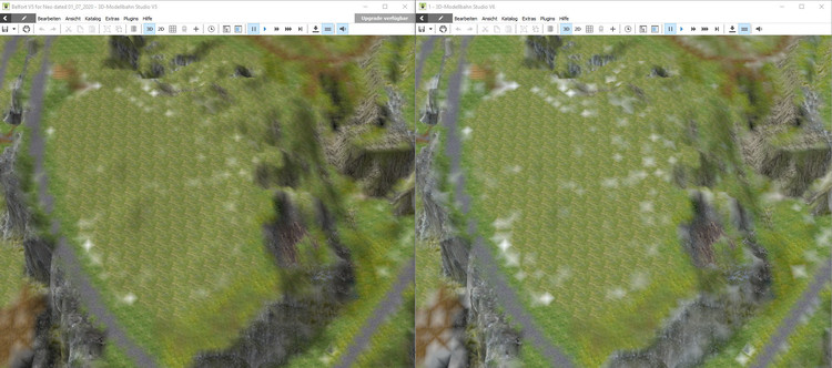

Hi Pete,
thank you for the V5 layout. If I remove all objects, I can see the gray spots in V5 too (V5 left, V6 right):

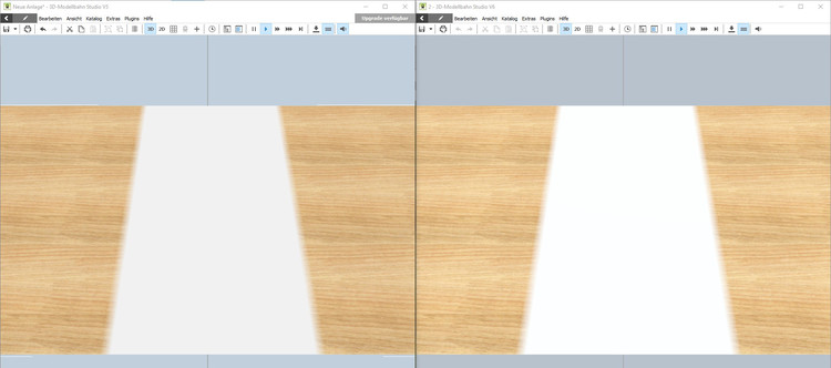

The reason the gray spots are more visible in V6 is called "gamma correction". Old versions prior V6 did not show colors the right way, why they were always a litte bit too dark. This error was corrected in V6. Have a look at this test scenary.
At this layout, a pure white texture was simply added to the ground. In V5, a pure white was more a light gray, in V6, it is a real white.
You can remove all white/gray spots in your layout by just replacing the white texture with a darker texture:
