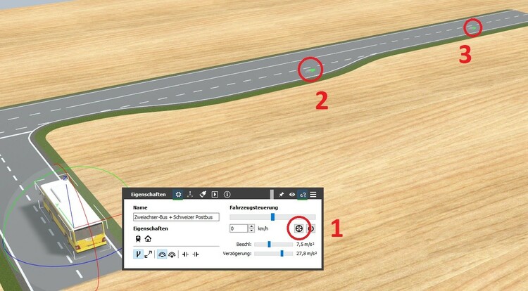

Goetz Geschrieben 9. Oktober 2021 Geschrieben 9. Oktober 2021 (bearbeitet) hello @220hotwheels, The short answer is: routes are for trains. Cars use destinations. Reason being that routes require switch points. They direct a train. Whereas cars are steered by the driver. He makes the decision, not the road. This led Neo to changing road traffic in V7 and treating it differently from train routes. Road junctions no longer have switch points inside. Only a bunch of active tracks with multiple connections. And the cars have inbuilt guidance systems. You click on the target icon in the engine properties menu and then on one or more contacts to send your car from A to B. I hope that helps and I'm not too confusing in my descriptions? Goetz Bearbeitet 9. Oktober 2021 von Goetz picture added

Goetz Geschrieben 9. Oktober 2021 Geschrieben 9. Oktober 2021 vor 21 Minuten schrieb 220hotwheels: "too many junctions" A maximum of 7 junctions is permitted between your car and the next waypoint (i.e. contact). A further 7 are permitted between this and the next waypoint. String up more waypoints where needed. But I suggest you start with short and simple rides to nearby destinations. Get a feel for it first, before you tackle "the big one"..
220hotwheels Geschrieben 9. Oktober 2021 Autor Geschrieben 9. Oktober 2021 A most sensible approach, thank you. I have one further question if I may. The destination route is shown in green when the vehicle to follow that route is highlighted. When the vehicle is not highlighted the destination route does nor appear. I assume therefore that the initial control of the vehicle is within the E.M. I note that for the trains the orange route only appears when the actual route is chosen in the routes list but there is no such lists for vehicle and their destinations. Kind regards Pete
Goetz Geschrieben 9. Oktober 2021 Geschrieben 9. Oktober 2021 Hi Pete, vor 2 Minuten schrieb 220hotwheels: I assume therefore that the initial control of the vehicle is within the E.M. Basically, you have two options you can set a round course for your car by stringing up a few waypoints. Make sure there's a legit connection from the last waypoint back to the current position, to complete the ring. you can use the E.M. to assign target contacts to passing vehicles at multiple key locations (e.g. crossroads). Kind regards Goetz

Goetz Geschrieben 10. Oktober 2021 Geschrieben 10. Oktober 2021 Hello Pete, vor 30 Minuten schrieb 220hotwheels: what constitutes a junction any fork in the road does, either when the path splits or when paths come together. A road crossing typically has 2 junctions for every possible path through: One leads into the crossing, the other one goes out. The former splits paths, the latter joins them. And you don't have to complete the ring. When the car has a legit path from the last waypoint to it's current position, it will automatically follow the same path again. And again ... KInd regards Goetz
