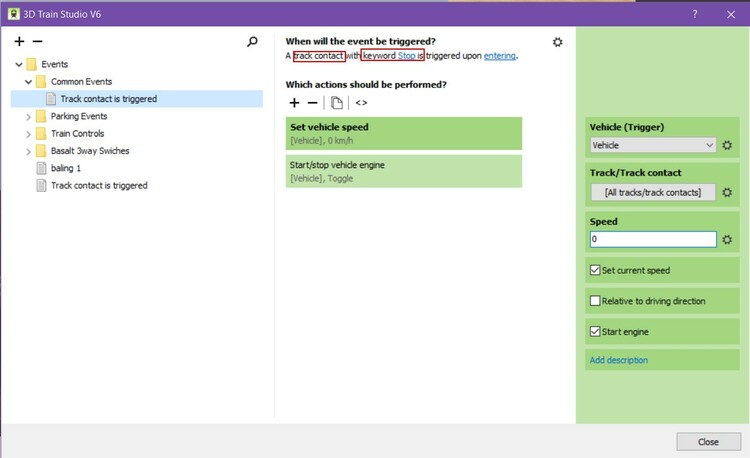

First, a keyword is a shortcut to name one or more objects in the Events Manager
In this case there are more than seven track contacts, and I want to set an event that will work for any of them.  Vehicle (Trigger) refers to the Locomotive (any) that triggers a "Stop" contact.

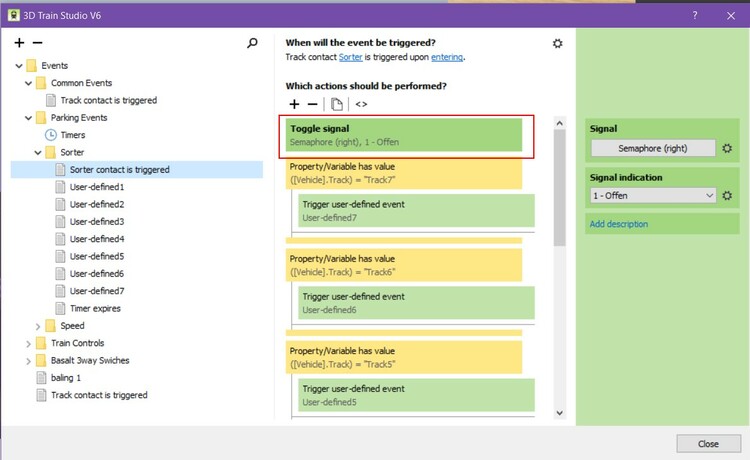

Here, I have used a track contact to trigger a track signal.  The rest of the event sets specific routes.

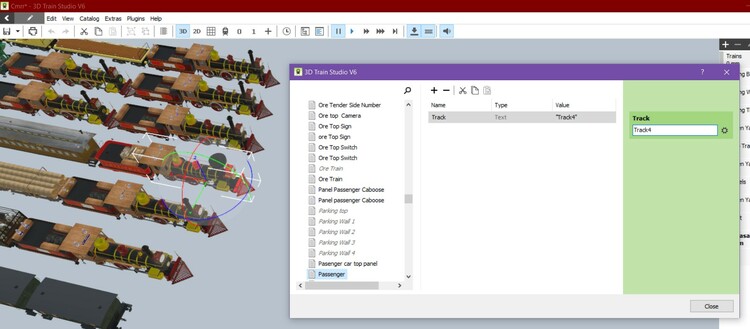

Each Locomotive has an object variable called Track that sets a specific track.

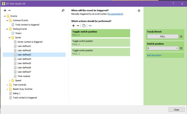

Here, The Track for Loco 3 sets a series of three track switches for track3

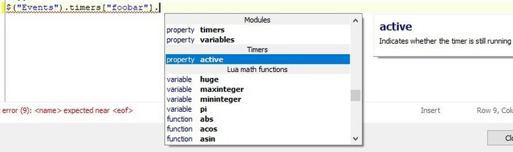

vor 11 Minuten schrieb Jud91:
Is it possible to display the time left on a timer
apparently not, George
The only timer property I can find is "active". Nothing beyond that.
Hello @Curt84328
the active state is the only property that I can access from within the event manager.
I cannot read and evaluate properties like the remaining time.

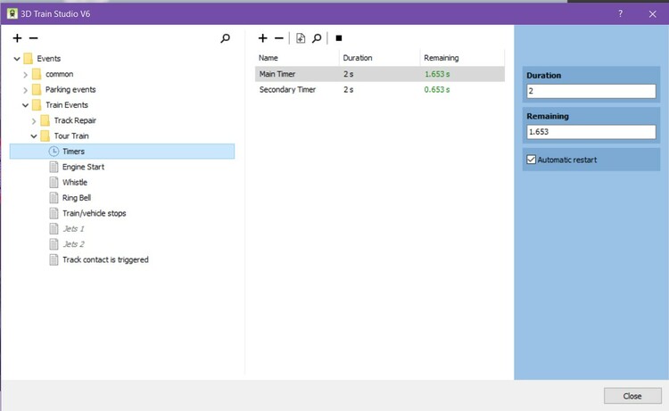

You can use the event tracer
Click the + under timers and variables to add those you want to see.
