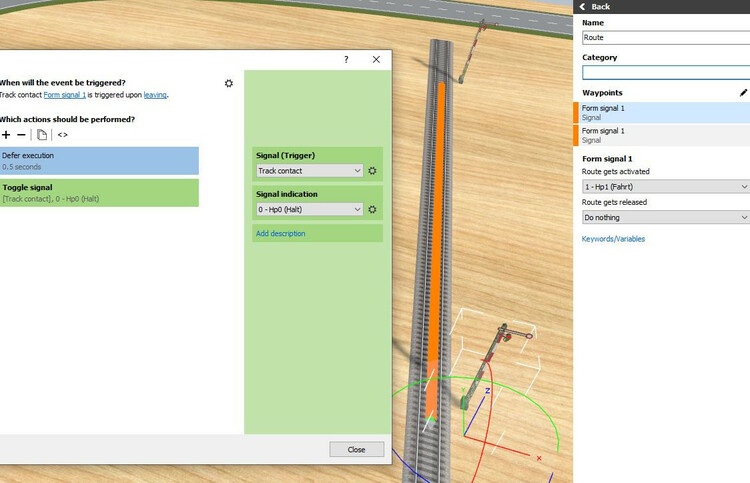

I saw today that a train, with a route does not set the signal on red when passing. This was certainly not so before. A solution is route get released -> Hp0, already when the train leaves the signal, not when released.  But my routes in some previous layouts have "Do nothing" when route gets released. I isolated it.  Test.mbp
Please some help or explanation. Thanks, Herman

routes.jpg.40ca28c775845827ab5fa4434b9b251d.jpg1190222219_treinstop.jpg.7d7fb8b7a5d67581f343b0924c2b49be.jpg

The cause for Hermans Problem is found in his screenshot
The default setting here is that the signal at the beginning of the route is set to HP0 upon release.
A route isn't released in its entirety, all at once, but section by section, with the signal at the beginning of the route being the first one affected.
The last signal of the route stays untouched upon release, because it isn't related to this route (except for marking its finish point)

14 hours ago, MichelLombart said:
I deleted the route and recreated it from scratch and everything seems to work when you activate the route.
Yes but on scratch, your sample  takes Hp0 when the route get released. I know that the problem was there. But not why.
Ja, aber bei Scratch nimmt Ihre Probe Hp0, wenn die Route freigegeben wird. Ich weiß, dass das Problem da war. Aber nicht warum.
12 hours ago, simonjackson1964 said:
I think the whole purpose of the "Route gets released" function is to set the signal to red,
Yes that is true, I only was wrong with "Route get released" the route  is not released at all when the train is passing, until the end point.
Ja, das stimmt, ich habe mich nur bei "Route get released" geirrt, die Route wird bei der Durchfahrt des Zuges bis zum Endpunkt gar nicht freigegeben.
I did not know that, this is the explanation I was searching for (y).  Das wusste ich nicht, das ist die Erklärung, die ich gesucht habe(y)
Can somebody give me a reason or example to ever use "Do Nothing" in this case ? But even not important...
Kann mir jemand einen Grund oder ein Beispiel nennen, warum man in diesem Fall "Nichts tun" verwenden sollte? Aber auch nicht wichtig...
Thank you all ! I'm very pleased with your help, kind regards, Herman Ich danke Ihnen allen! Ich bin sehr zufrieden mit eurer Hilfe, mit freundlichen Grüßen, Herman

The signal is considered "passed" when the middle of the train runs over the signal's contact.
Depending on where the contact sits (in relation to the signal itself), some purists may consider this to be too early for switching the signal back to red.
With different periods and different signal types, it varies when a signal ist set to red. With old semaphore type signals and a junction box with large levers, the "Fahrdienstleiter" would first check the passing train. In particular, he'd  verify that the "train end" signals are in place on the last waggon. Missing train end indicators may indicate that a waggon was lost somewhere back. After the entire train has passed the signal, the controller would turn to his lever bank and change the signal.
Modern signals typically switch to red automatically, when the engine has passed. i.e. long before the complete train went through.
The "Do nothing" option gives you the reqired flexibility to model real world behaviour as you desire ...

So basically, you could set the route to "do nothing" and then have an event on the signal's track contact "upon leaving"...
This makes perfect sense to me. (Half second delay added for the signalman's reaction time!)
