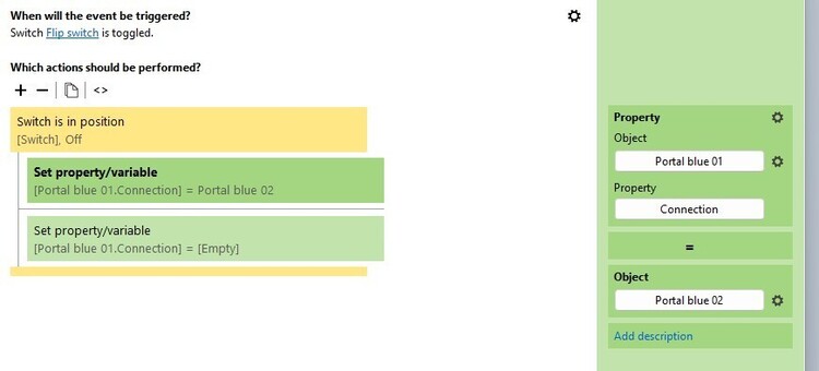

Herman Geschrieben 22. August 2023 Geschrieben 22. August 2023 (bearbeitet) Port connection via EV.mbp Beta version 8.5.2.0 needed. Herman Bearbeitet 23. August 2023 von Herman

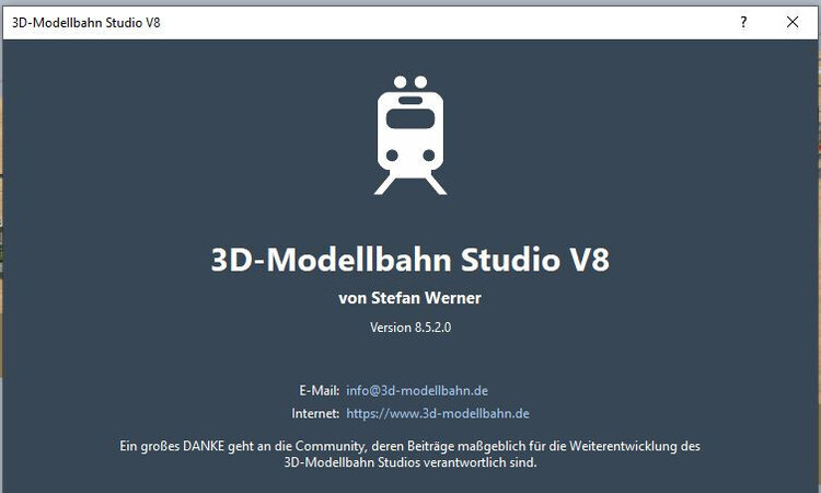

simonjackson1964 Geschrieben 23. August 2023 Geschrieben 23. August 2023 It doesn't open on V8, presumably needs an update?
Klartexter Geschrieben 23. August 2023 Geschrieben 23. August 2023 vor 34 Minuten schrieb simonjackson1964: It doesn't open on V8, presumably needs an update? Hello @simonjackson1964, do you have this version: Kind regards Walter
Herman Geschrieben 23. August 2023 Autor Geschrieben 23. August 2023 (bearbeitet) 1 hour ago, simonjackson1964 said: It doesn't open on V8, presumably needs an update? Yes @simonjackson1964 8.5.2.0 beta is needed. Sorry. But it is a new feature. Could be interesting if you want to send the train to another portal via event management. ( EV ) Just the code as preview : Kind regards, Herman Bearbeitet 23. August 2023 von Herman
simonjackson1964 Geschrieben 24. August 2023 Geschrieben 24. August 2023 I see, this does look interesting. So for example, I could have a start portal with a V-depot feeding road vehicles to it, a list of end portals, indexed via a random number generator, and have the road vehicles go to a randomly selected entry-point on the layout? I had (at version 7) a layout that had almost every variant of almost every road vehicle (except a few I didn't like) loaded in a V-depot, and they would pick a random route down a hidden road with lots of junctions, to arrive at the portal that linked to the entrance point. But this new thing would be a lot more efficient. Sadly a computer failure means I no longer have that layout. And yes I know I should have backed them up. Lesson learned.
simonjackson1964 Geschrieben 24. August 2023 Geschrieben 24. August 2023 Sorry for the double post... Could this feature be expanded to allow the connection property on other objects to be accessed via EV? So for example, In the above situation the connection between the main and advance signal could be changed depending on the point setting?
Goetz Geschrieben 24. August 2023 Geschrieben 24. August 2023 vor 1 Stunde schrieb simonjackson1964: In the above situation ... you can already use the EV to respond to a changing main signal and set the advance signal accordingly, taking the current switch setting into account. Similar effort, just a different approach. Does that help?
simonjackson1964 Geschrieben 24. August 2023 Geschrieben 24. August 2023 I know, but if the junction wasn't there, I'd just connect the two signals together, set the advance signal to "Do Nothing" on the route it's actually in, and leave it at that.
Goetz Geschrieben 24. August 2023 Geschrieben 24. August 2023 Is Lua an option for you, @simonjackson1964? The following code does exactly what you were asking: if track.state == 0 then $("Formvorsignal 1").connection = $("Formsignal 1") else $("Formvorsignal 1").connection = $("Formsignal 1#2") end The property "connection" is the type of link that lets one signal mimik the other. This property became available with version 8 of the software The "track.state" in my example is the condition of a switch point, which I used to trigger the event.
