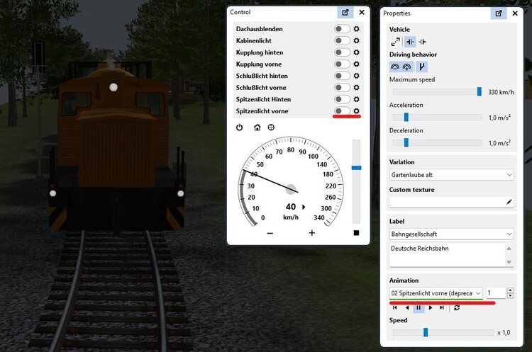

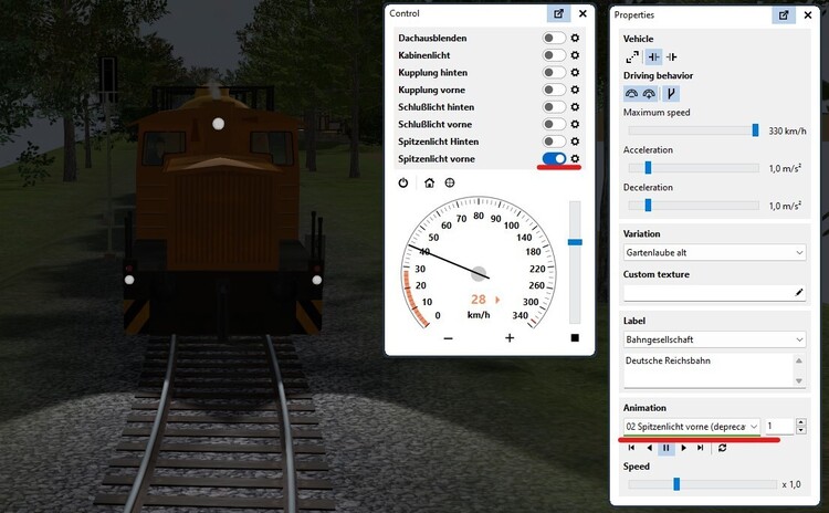

Phrontistes Geschrieben 4. November 2024 Geschrieben 4. November 2024 Hi @Herman You can vary the lights even more. Pay attention to the switch position, animation position and the results: If you don't want the somewhat unrealistic lighting of the track, just continue using the animation.
