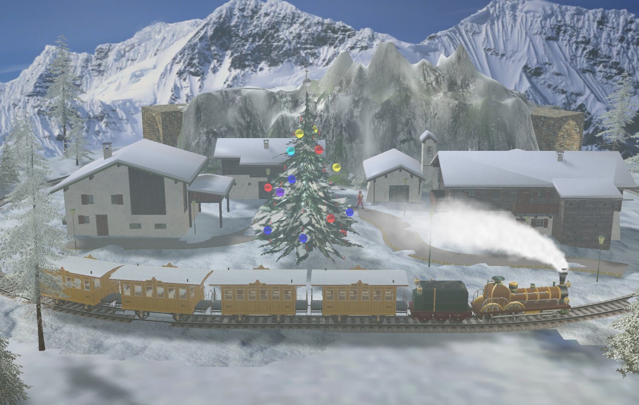

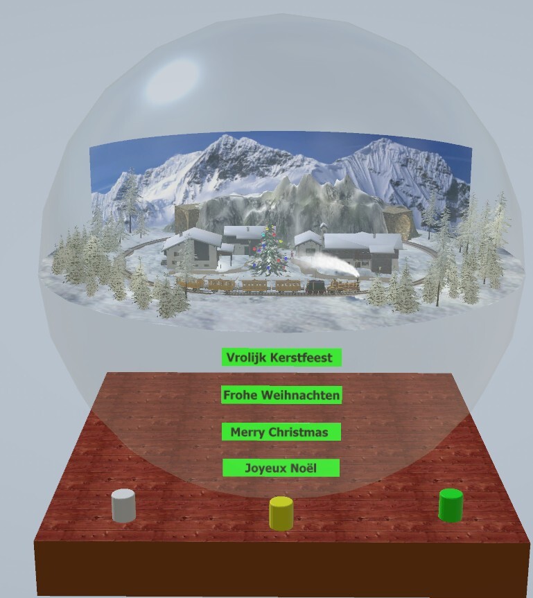

  4. 684EDDD8-436C-4F37-A99D-96C673EC110D (v9.5) (draft) Merry Christmas wishes from Herman
