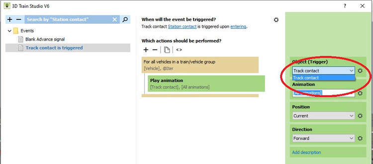

simonjackson1964 Geschrieben 2. März 2021 Geschrieben 2. März 2021 So, I figured it would be quite clever if an electric train pulls into the station and all the doors slide open. the train waits for a few (scale) minutes - i.e. ten seconds - then closes the doors and heads off up the track. So I can make the first car in the train (the one driving) open the doors, but I can't figure out the iteration to make it do the rest. It should be "For every vehicle on a track/contact" or "For every vehicle in a train/group" (Not the exact wording but you know which I mean...) But the only animations I can get at are (non-existent) ones fr the track contact that triggers the event. In fact, I don't seem to be able to reference vehicle animations at all, directly. I had to go into the code editor and fiddle with it to get it to do just the front coach. Surely this is a bug? Surely the whole point of the two iterations I mention above is to be able to play the animations on every car/wagon in a train?

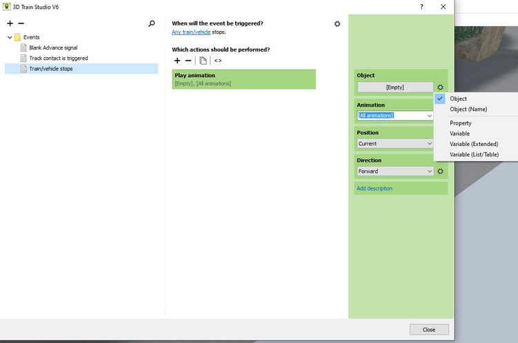

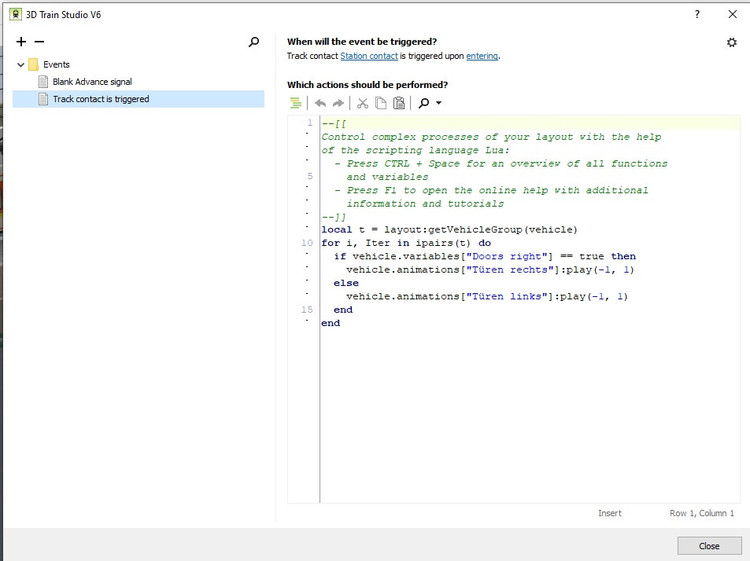

simonjackson1964 Geschrieben 3. März 2021 Autor Geschrieben 3. März 2021 @Goetz Have you tried to put the "Play Animation" action in the iteration? It will only allow "Track Contact" In fact try accessing any vehicle animation from any event? Note the absence of a "trigger" option. If you want a vehicle to play one of it's animations when it triggers an event you have to name it explicitly! Which rather defeats the object of those iterations. I did manage to get the first set of doors to open by doing this: But it's only opening the doors on the first car. (The variable "Doors right" is an object level boolean on each car because it's an E.M.U. with the trailing drive unit facing backwards - plus I wasn't certain which way round the centre cars were either.)
Goetz Geschrieben 3. März 2021 Geschrieben 3. März 2021 (bearbeitet) Your Lua code is flawed for i, Iter in ipairs(t) do i and Iter generate two local variables and in ipairs fills them with the key and the value of one element in table t You don't need the key of the cell. But you need it's value, because that is your waggon. Your vehicle which is why the next lines should have iter in place of vehicle. Or - better - change the line from above into for i, vehicle in pairs(t) do I agree that the graphical EV doesn't cover everything. Which is why it's a godsend, that you can switch to Lua where needed. Bearbeitet 3. März 2021 von Goetz
simonjackson1964 Geschrieben 3. März 2021 Autor Geschrieben 3. März 2021 25 minutes ago, Goetz said: yes, there is - check my example, please select the iteration as your object. That's what you iterate over the train for, Simon. Sorry, you're right. I just tried. And then I remembered, why I stuck part of the code in a separate, user defined event. Because I can pass the element from my iteration on to that event. And now it's a trigger, which I can use as a target for my animation call. Am I making sense? Or should I try for a better explanation? Thank you. Right, so I have managed to create the user defined event, and call it from the iteration... But it is still only opening the doors on the first car. 7 minutes ago, Goetz said: Your Lua code is flawed for i, Iter in ipairs(t) do i and Iter generate two local variables and in ipairs fills them with the key and the value of one element in table t You don't need the key of the cell. But you need it's value, because that is your waggon. Your vehicle which is why the next lines should have iter in place of vehicle. Or - better - change the line from above into for i, vehicle in pairs(t) do I agree that the graphical EV doesn't cover everything. Which is why it's a godsend, that you can switch to Lua where needed. That explains that. I had a feeling it was something like it, but I wasn't sure of the syntax. I think I will try that first.

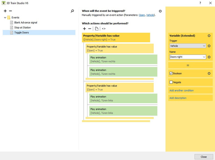

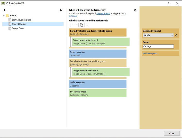

simonjackson1964 Geschrieben 3. März 2021 Autor Geschrieben 3. März 2021 The final product: The second parameter on the User Defined Event is so I can use the same event to open and close the doors. I went back to the graphical EV because I couldn't get the second deferral to work in Lua. The train left while closing the doors or closed them the left while opening them again... I know it was a bug in my syntax, but I can't be bothered to fix it, because I realised what I was doing wrong in the graphical version, fixed it and it works! (It should be obvious but one of each pair of animations is forward and one is backward). Posting this because I like celebrating my success, but also because there might be someone with a similar issue, and they might see this and think "Oooooh!" First time using a user defined event, and I think I've got the hang of how they work and how useful they can be, too!
