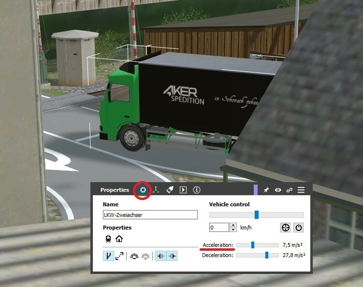

Is there any way to set / change the vehicle acceleration value?
Hi @georgeb,
sofern das Modell über einen Antrieb verfügt: Modell anklicken und im Eigenschaftsfeld dieses Modells kannst du deine Voreinstellungen ändern
Gruß Karl
if the model has a drive: Click on the model and in the properties field of this model you can change your default settings.
Greetings Karl
vor einer Stunde schrieb georgeb:
Is there any way ...?
There are two, George.
A manual way ...
... and event management
Greets
Goetz
Is there a tutorial ..?
Hello George,
does my screenshot not explain everything you need to know?
I highligted the one aspect that someone might miss.
Kind regards
Goetz
It worked perfectly for me.  you are a great (and rapid) help to mr.  Thanks.
