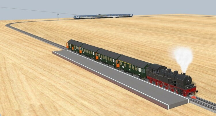

vor 41 Minuten schrieb raf.sonneville:
Can u send this as pdf file pls?
A layout as a pdf file?
Are you having me on, Raf?
Or do you maybe misunderstand the term layout? Just in case, here's a picture of it:
9_9

Hi Goetz
Sorry to disturb you again
I tried your layout and works fine.
Then i tried this on my layout with nearly 30 trains and it works wonderful.
Whatever train that stops at a signal the doors open.... however...
The doors don't close when th train leaves, and the reason is that I am using automated routes, the trains stop at a signal and stand therewaiting until the signal is turned green by the automated routes.
This means that the command "For all vehicles on a track/contact" does not work because I cannot not use a trigger there.
If a put this command within the command for a signal changing to green then I cannot select at" Vehicle" on the right the trigger option, so the train leaves when the signal goes green but the doors don't close.
