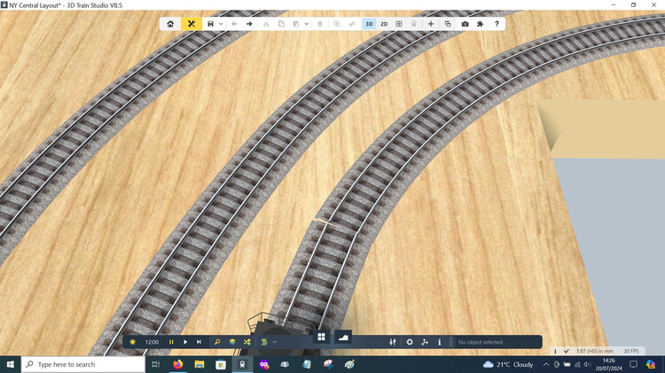

Well done! I noticed a misaligned join at x=-987.5, y=-30.01. Not sufficient to stop the train, but enough to make it jerk with unintended realism (when compared to the US prototype - the condition of the tracks over there would never be accepted in Europe!). I would just move one or other of the track ends using the flexi-track tool to realign them. So now you need some scenery? The signals supplied with MBS are almost all German, as is most of the rolling stock, but I honestly have no knowledge of US railway signalling at all. I know British signals and practices, and thorough research and asking questions on this forum has given me a working know;edge of German signals.... But what I do know is how the Route system works on MBS - from trial and error and playing with it! Scenery itself I can certainly help with. Scratch-building with Primitives is actually something I enjoy doing and it's good because what you build doesn't require uploading seperately, which is the case with other modelling programs. I'm not certain if you can use my email address to find me on Facebook? It's not something I've ever done. I know you can with Teams. Hope to chat soon? Simon

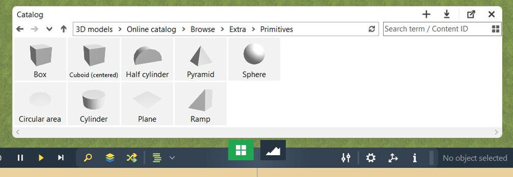

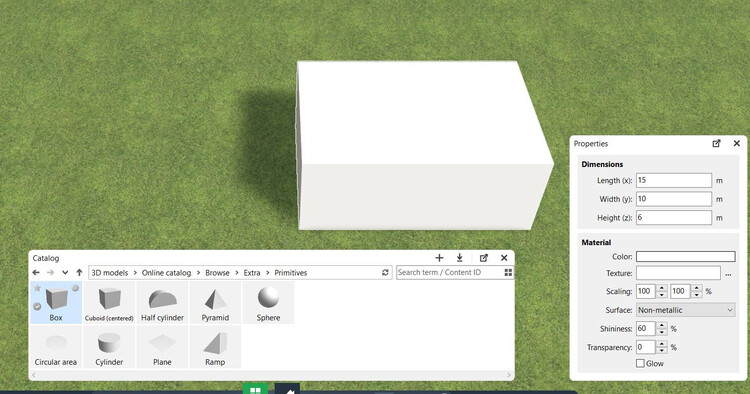

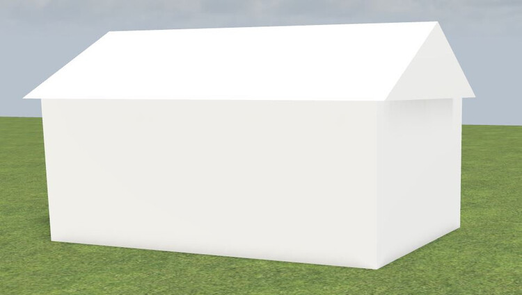

I don't think there are videos as such. If I hadn't lost my saved layouts, I would share them, but I can certainly show you what I mean... The one thing that is a bit unfortunate with these primitives is that you can't make holes in them, but depending on the level of detail you are after, they are great for scratch-building or kit-bashing. I generally work in the 1:1 scale, as I'm not simulating an actual model. I am guessing your layout is O-Gauge? (To quote Sheldon Cooper, "O-Gauge or no gauge!" Ha ha!) I used to model in N because of space, but it's actually more expensive than HO/OO in England! Anyway, put a box on the baseboard, and set it to the size you want... Make sure the positioning is set to "Stack" and pop a couple of ramps on top... Sized and positioned correctly, and hey presto, you have a house... There is a lot you can do to this template to make it more realistic, obviously textures are a good idea. Instead of ramps, a couple of pyramids on either end covered by planes set at the right angle (remember your trigonometry from school? Ha ha!) can give a more realistic roof. A half cylinder along the ridge-line looks like ridge-tiles with the proper texture, A ha;f cylinder upside down can be the guttering, and cylinders sided correctly in the right places make great guttering. Windows are a problem, but I've found that a small plane made 100% reflective and positioned 1mm off the surface of the main box works fine. A similar technique for doors, making them a wood texture. Like I said, it all depends on how detailed you want your scenery. The other great use for the primitives is to fill holes in the baseboard created by bridges and tunnels, as shown in my post here... The screenshots from the actual layout are from this one: 7C346FA4-A33E-4148-A0EE-3D0F790B8524 - I just checked, and it is still accessible even though it's a draft upload. It's got lots of primitives in it making various details. Unfortunately, the track is too complex for me to get it working - I'm too ambitious, but I love building them! If you want to chat in real time, I'm currently off sick from work and available to chat. I have Facebook and Teams. Anyway, I hope this is of help.
