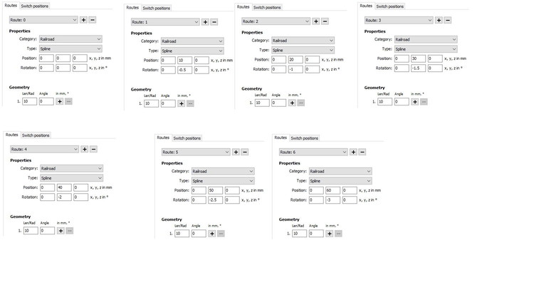

Hi Tom You said "Here I find it easier to use a scaled down (0.1) loco ... for spreading the tracks out" I am intrigued! I cannot scale a loco. When on the track the loco will not scale. When off the track it will scale to 0.1, but as soon as I put it on the track it re-scales itself to 1 Cheers Eric
Twisted track
Hi Bahnland 1. Using the track editor to produce a curved slope is much easier than joining together small pieces of curved track with many different angles. Also the resulting 'cockpit' view is more pleasing. 2. You are absolutely right about the switches - they are totally unnecessary. Thank you for pointing that out. Many greetings Eric Twisted tracks without switches.mbp

If you have a slope which is curved the end of the slope may not be level. You can use a "twisted" track to correct this. You can make a "twisted" track using the track editor: Stage 1: Create six routes as follows Stage 2: Create two switch positions. Switch 0 actives Routes 0,1,2,3,4,5,6. Switch 1 also activates Routes 0,1,2,3,4,5,6 PLEASE NOTE: Edit: Bahnland has kindly told me that stage 2 in NOT NEEDED - so please ignore it! (I am grateful to Goetz for this idea - I learnt this from studying one of his Points designs) That's all you need to do. I know that you could achieve the same by using a group of 7 tracks but I think this is a neater method.Twisted tracks.mbp Best wishes to all Eric

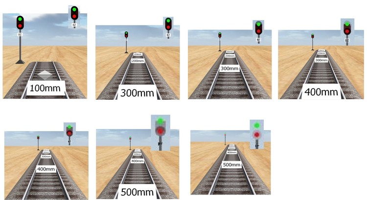

Hi Andy I didn't realise that unless my signal is in the catalogue it will not appear. I thought it was contained inside the .mbp file. My signal is functional but not pretty - it does not compare well to the quality of the German signals in the catalogue. When I produce a better looking version I will upload it. Cheers Eric P.S. My original title "Disappearing Signals" has proved to be true in this mbp file!
Here is the "cube mark 2" produced using Blender. It is a very simple model but it behaves correctly as a signal. Simple British Signal.mbpSimple British Signal.mbp
"From tiny acorns great oak trees grow"
Thank you very much, Andy. I'm now keen to become proficient with Blender. But it's a steep learning curve! UPDATE: Fantastic! Success! I now have a working "cube" which behaves as a signal and can be seen in cockpit view from over 1000mm. Once again, thank you very, very much - this is something that I have been wanting to do for a long time.
Hi Andy Thank you for your suggestion. I have spent all day (I'm retired!) reading the forum about Blender 2.8. I'm going to have a go tomorrow. However, I am still not clear how to 1. Create an object that will behave like a digital switch 2. Create an object with a contact point. I've read the Wiki "Model making>functional models, control objects" "(Modellbau>Funktionmodelle>Signale, Steuerobjekte)" but I don't understand how this relates to Blender. Could you point me in the right direction? - I'm not asking you to do the work for me! Thank you Eric
Hi Metallix I don't want to ask someone else to do the work for me. Ideally,I would like to go for option C) build my own signals using model-making software but I haven't got any idea how to start! I've downloaded Blender but I cannot think how to start building a signal Cheers Eric

Hello Members I have tried to make some signals that resemble those used on British railways. Since I do not know how to make new models, I have assembled them from Primitives and Buttons already present in the MBS catalogue. Everything seemed to be working well until I used the "Enter Cockpit" camera of the Loco. I then discovered, to my dismay, that the signals appeared and disappeared according to their distance from the Loco. (This does NOT happen when using a free camera attached to the Loco.) I have enabled the "Glow" feature of some of the components but this has not solved the problem. Can anyone offer me advice? I would really like to use some realistic-looking signals. Unfortunately, the German signals are very different to the British ones. Thank you in advance for any suggestions. Best wishes Eric Disappearing Signal.mbp
