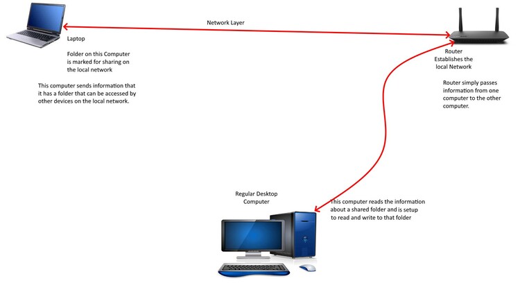

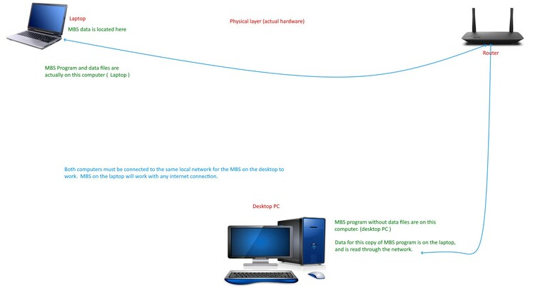

Here are the basics of how folders and data are shared on a network.
This is a simple network with 2 computers and a router.  While connected to the same network, both computers can use the same data, but only one at a time.
Here, the Laptop (While connected to the network) sends information that a folder on it's hard drive can be read by and written to by other computers on the network.
The other computer must be setup to read this data (Once)

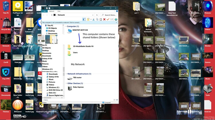

Here, We are looking at the Network from within Windows 10.  Desktop-9KTF1H9 can be seen, because it is the local computer.  Other computers will not see it, unless it has something to share.  Below this computer (Expanded) are the folders that have been marked to share.  below that are my router, and my Roku.

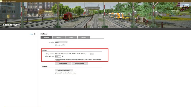

As @Curt84328 explained before, select the "settings" menu from the start page of your studio
In the settings menu, locate the "database" section and change the "save" destination to your drop box folder.
