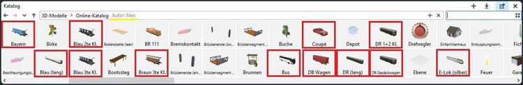

  12. Hello @220hotwheels! Maybe the "Tracks" (straight or curved) will job as Workarround for you? I have marked the components with the blue arrows. They are as a Typ "Spline" declared, so you can bend them, length them or crop them. You can of course also scale the components. The color "yellow" (in German: "Gelb") can also be selected as a variation, I have marked it for you with the yellow arrow.
