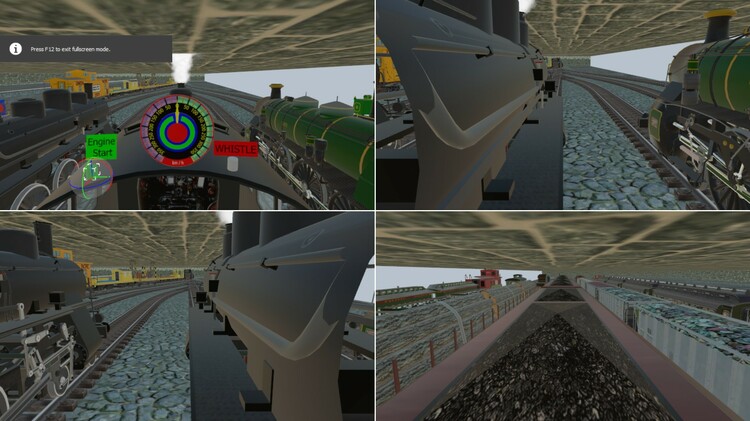

  8. I should add that I just noticed that two of the camera views are in the wrong frame. Easily fixed. also Frame 0 (Top left corner) has an engine start button. I select this view with the numbers at the top center of the program, and pressing the engine start button then activates the other views via EV.

  11. Dad3353 is correct, I have used up to 50 or more cameras. Events makes it easy to manage, and with Multi-view you can display more than one at a time. Just on my trains alone I have over 28 cameras. Curt
