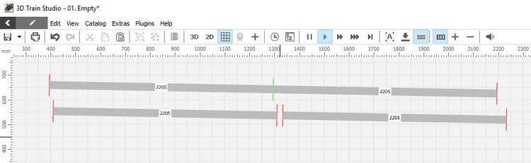

  9. You can tell, when you switch to the grid view. Green line between track elements -> connected Red line between track elements -> unconnected Edit: Beg your pardon. I missed that Trevor already gave that answer.
