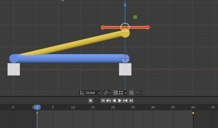

Dad3353 Geschrieben 18. September 2021 Geschrieben 18. September 2021 Once again, I couldn't sleep, turning over and over the way to do Animations. It's already one thing to create them in any software package, but they have to be compatible with the requirements of the MBS 3D Train Studio. Blender is, I must admit, not the most intuitive software, either. However, once one ignores the technicalities of Real Life, and, by a process of Parallel Thinking, adopt a simple, pragmatic approach, things become easier (or, at least, when doing simple tasks...). I already have a static Pantograph model, and have been searching for months, on and off, how to use Pivots or Hinges in Blender, and how to inform MBS of a Blender animation. Not for me the mysteries of .x files; is there anything more 'User friendly'..? The illumination came in the dark, in bed, listening to supposedly sleep-inducing music. No, I must just try the idea out, and straight away. It was so easy, once I accepted the notion that it's OK to 'cheat'..! There is no articulation, it's just four separate sets of coordinates being changed simultaneously, so as one arm changes angle, another part simply rises into the air. There is no real linkage; it's an illusion. Better yet, the export from Blender apparently pleases MBS, and the animation is imported automatically. No, I don't yet know how to import several different animations, but I'm very pleased with this first one, so I had to post this very short video, after which I really must get some sleep. This stuff is addictive..! Wieder einmal konnte ich nicht schlafen und drehte mich immer wieder um, um Animationen zu machen. Sie in jedem Softwarepaket zu erstellen ist schon eine Sache, aber sie müssen mit den Anforderungen des MBS 3D Train Studio kompatibel sein. Blender ist, ich muss zugeben, auch nicht die intuitivste Software. Wenn man jedoch die technischen Details des wirklichen Lebens ignoriert und durch einen Prozess des parallelen Denkens einen einfachen, pragmatischen Ansatz verfolgt, werden die Dinge einfacher (oder zumindest bei einfachen Aufgaben ...). Ich habe bereits ein statisches Pantograph-Modell und suche seit Monaten hin und wieder, wie man Pivots oder Scharniere in Blender verwendet und wie man MBS über eine Blender-Animation informiert. Nicht für mich die Geheimnisse von .x-Dateien; Gibt es etwas 'Benutzerfreundlicheres'..? Die Beleuchtung kam im Dunkeln, im Bett und hörte angeblich schlaffördernde Musik. Nein, ich muss die Idee einfach ausprobieren, und zwar sofort. Es war so einfach, als ich die Vorstellung akzeptierte, dass es in Ordnung ist, zu 'betrügen'...! Es gibt keine Artikulation, es werden nur vier separate Koordinatensätze gleichzeitig geändert. Wenn also ein Arm den Winkel ändert, hebt sich ein anderer Teil einfach in die Luft. Es gibt keine wirkliche Verbindung; es ist eine Illusion. Besser noch, der Export aus Blender gefällt MBS anscheinend und die Animation wird automatisch importiert. Nein, ich weiß noch nicht, wie ich verschiedene Animationen importieren kann, aber mit dieser ersten bin ich sehr zufrieden, also musste ich dieses sehr kurze Video posten, danach muss ich wirklich etwas schlafen. Dieses Zeug macht süchtig..!
maxwei Geschrieben 18. September 2021 Geschrieben 18. September 2021 Hi DAD If I see this correctly you are using a pure keyframe animation, correct me if I'm wrong, where you store start and end positions, possibly also intermediate positions of each mesh? If you want I can explain you how to do this with a bones animation in 2min. cheers max
Dad3353 Geschrieben 18. September 2021 Autor Geschrieben 18. September 2021 4 hours ago, maxwei said: ...If you want I can explain you how to do this with a bones animation in 2min. ... Good afternoon, @maxwei Yes indeed, there are two keyframes (one for the start 'down' position, one for the final 'up' aspect...) The Machine works out everything in between. It's all that's required for such a simple action, and will work in similar fashion if I cut out sliding doors, for instance. On the other hand, 'bone' animation is the way to go for more complex movement, such as characters, where multiple axis could be involved. If you've a two minutes explanation, I've more than two minutes to spare, so I'd say 'Yes' to that, with enthusiasm. I've looked at it, naturally, but not (yet...) had the 'light bulb moment' whereby I can realise that I can do it. I've more and more questions, anyway, triggered by having more and more answers. Does it ever end..? I hope not..! Thanks for the offer; I'm all ears; meanwhile... Have a splendid day. Ja, es gibt tatsächlich zwei Keyframes (einen für die Startposition „unten“, eine für die letzte „oben“-Position...) Die Maschine berechnet alles dazwischen. Das ist alles, was für eine so einfache Aktion benötigt wird und funktioniert ähnlich, wenn ich zum Beispiel Schiebetüren ausschneide. Auf der anderen Seite ist die "Knochen"-Animation der Weg für komplexere Bewegungen, wie zum Beispiel Charaktere, bei denen mehrere Achsen beteiligt sein könnten. Wenn Sie eine zweiminütige Erklärung haben, habe ich mehr als zwei Minuten Zeit, also würde ich mit Begeisterung „Ja“ sagen. Ich habe es mir natürlich angeschaut, hatte aber (noch...) nicht den 'Glühbirnen-Moment', in dem ich erkennen kann, dass ich es kann. Ich habe sowieso immer mehr Fragen, ausgelöst durch immer mehr Antworten. Endet es jemals..? Ich hoffe nicht..! Danke für das Angebot; Ich bin ganz Ohr; inzwischen... Hab einen herrlichen Tag. Douglas

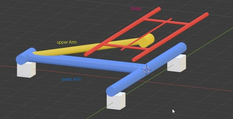

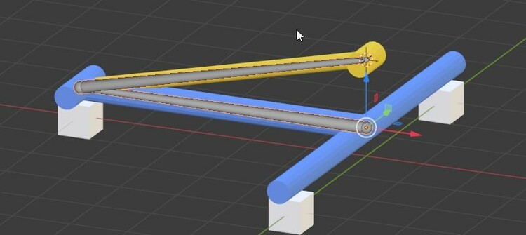

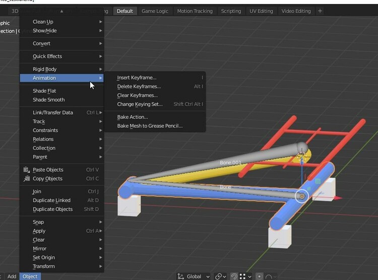

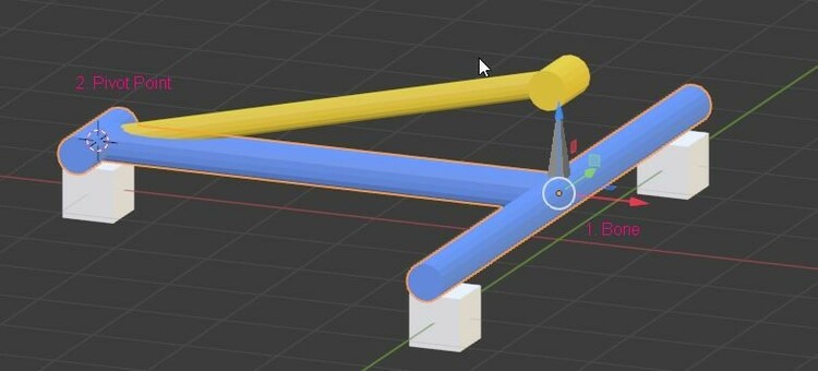

maxwei Geschrieben 18. September 2021 Geschrieben 18. September 2021 (bearbeitet) Ok, here we go: Your approach is basically correct as long as it stays with simple animations without angle changes or ratios between different meshes (objects). But if you then, as in this case, build a more complex pantograph with a lifting system of different strings, you reach the limits with a keyframe animation and is then very difficult to correct and a tedious job. It is better to let the software do this work for us. The following probably reads very complicated and is certainly difficult to understand at the beginning, but once you understand the system behind it, it is easy to create more complex animations in the future. Ok, let's start: I created a small example for the simple bones animation. In this case we create 3 objects Slider (this, and only this remains in a keyframe animation because it is linear) upper arm lower arm We don't want to animate more than these 3 because the rest can be joined to an existing (animated) mesh. Now you animate the slider (and only the slider) vertically as a normal keyframe animation, but you should make sure that the height fits after the import into the MBS and that the slider is in contact with the contact wire. (As an example we take frame 1-40, so approx. 1.5 sec.) This looks like this: (but you know and can do that) Now we go to the bones, sounds more complicated than it is, you just have to understand the system behind it, then much explains itself. We now create 2 bones, one for the lower and one for the upper arm which is linked to the slider. For this we have to understand that we have 3 pivots. We now set the Pivot Point with Shift S to the first pivot point. Now we create the first bone (Shift A armature). We now set the Pivot Point to the 2nd pivot point. Select the 1st bone. In Edit mode- we attach the end of the bone to the 2nd pivot point with SHIFT S (Selection to Cursor). We stay in edit mode and with E we immediately attach the 2nd bone to it (just drag it towards Z for the moment). Now we do the same with the 3rd pivot point. First we put the Pivot Point to the pivot point, then in Edit Mode of the bone we put the end of the 2nd bone to the 3rd pivot point again with SHIFT S (Selection to Cursor). Now the whole should look like this, by the way you can change the display of the bones here: (In this case as with me as Envelope, which one sees just better) Now the bones are set (which are nothing else than a template for animations to which the corresponding meshes (objects) are attached). Now we will animate the bones with a very simple trick. To understand: The end of the bone chain should do nothing else than lift with the slider, the rest has to happen automatically, and it happens like this: Select the 2nd bone and in pose mode: activate the bone constraint and that is: "inverse kinematics", as target we select the slider because with it "upper" and "lower" arm should be connected. This is how it should look now and the bone animation is done, but now the connection of the real meshes is missing. For this we now link the upper/lower arm to the existing and animated bones: Select the lower arm and give it a "Child" constraint over Bone, the same then of course with the upper arm and Bone.001 (press "Clear Inverse" once and "Set Inverse" once). This completes the animation of the meshes, but........... But the whole does not work in the MBS, why? Because the MBS doesn't support direct bones animation, but it doesn't matter, because now we transform the bones animation into a keyframe animation like this: Select the lower arm again and activate "Bake Action" under Objects/Animation, select everything and press "OK", the same with the upper arm, and that's it. Now you can export and with the *.varlist *.anim (corrected)you define the animation in the MBS, as an example: Pantograf;1;40;noloop;noautoplay finished cheers max DAD_Pantograf.zip Bearbeitet 19. September 2021 von maxwei
Dad3353 Geschrieben 18. September 2021 Autor Geschrieben 18. September 2021 (bearbeitet) 38 minutes ago, maxwei said: Ok, here we go: ... What kept you ..? ... ... No, seriously ... That's my evenings cut out for the next few days, at least ..! Many thanks for such a clear exposure of the steps involved, plus the added bonus of the attached files to play around with. You're right, it's not light reading in the same way as a Herman Hesse novel, but requires some study, some experimentation and some modicum of intelligence ..! Not sure about the latter, but with such a description before my eyes, it'll all make sense when I actually do it for myself. I certainly wasn't aware of the 'baking' part in order to get MBS to treat the animation. I presume that the 'varlist' part is how one makes several different animation available ..? My simple pantograph had no such extra file; it seems to have been included in the export from blender. It makes things simple, but a 'varlist' gives more flexibility, I suppose. I'll find out once I get some 'hands on' experience, and that starts now ..! I make take a little more than two minutes, for the first ones, probably, but this information will serve over and over again, once assimilated. I'm imagining the wave of a child at the level crossing as the loco passes by, or a mail train 'catching' mailbags from an extended perch. More midnight oil to burn, then; thanks for the time and trouble taken. catching 'mailbags from an extended perch. More midnight oil to burn, then; thanks for the time and trouble taken. catching 'mailbags from an extended perch. More midnight oil to burn, then; thanks for the time and trouble taken. Keep well, stay safe. Das sind zumindest meine Abende für die nächsten Tage..! Vielen Dank für eine so klare Darstellung der erforderlichen Schritte und den zusätzlichen Bonus der angehängten Dateien zum Herumspielen. Sie haben Recht, es ist nicht so leicht zu lesen wie ein Roman von Hermann Hesse, sondern erfordert einige Studien, einige Experimente und ein bisschen Intelligenz..! Bei letzterem bin ich mir nicht sicher, aber mit einer solchen Beschreibung vor meinen Augen wird alles Sinn machen, wenn ich es tatsächlich für mich selbst mache. Ich war mir des "Backens" sicherlich nicht bewusst, um MBS dazu zu bringen, die Animation zu behandeln. Ich nehme an, dass der 'varlist'-Teil dazu dient, mehrere verschiedene Animationen zur Verfügung zu stellen..? Mein einfacher Stromabnehmer hatte keine solche zusätzliche Datei; es scheint im Export aus Blender enthalten gewesen zu sein. Es macht die Dinge einfach, aber eine 'varlist' bietet mehr Flexibilität, nehme ich an. Ich werde es herausfinden, sobald ich einige praktische Erfahrungen gesammelt habe, und das beginnt jetzt..! Ich lasse für die ersten wahrscheinlich etwas mehr als zwei Minuten dauern, aber diese Informationen werden immer wieder verwendet, wenn sie einmal aufgenommen wurden. Ich stelle mir das Winken eines Kindes am Bahnübergang vor, während die Lok vorbeifährt, oder ein Postzug, der Postsäcke von einem ausgezogenen Sitz aus „fängt“. Also noch mehr Mitternachtsöl zum Verbrennen; danke für die zeit und Mühe. Bleiben Sie gesund, bleiben Sie gesund. Douglas Bearbeitet 18. September 2021 von Dad3353
