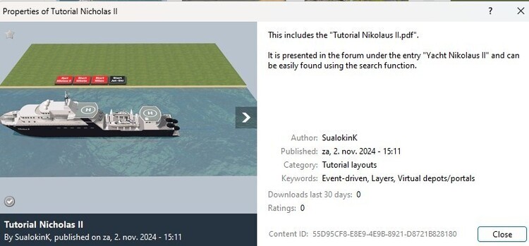

Herman Geschrieben 2. November 2024 Geschrieben 2. November 2024 (bearbeitet) Hello @220hotwheels , you have to publish it first, a draft is good enough. Then under properties the content Id Number. As example the Nikolaus just published today Crossed the message from Götz. Pete, I'm also eager to see what FPS that layout gives here. Regards, Herman Bearbeitet 2. November 2024 von Herman typo

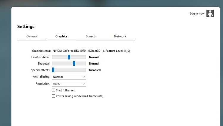

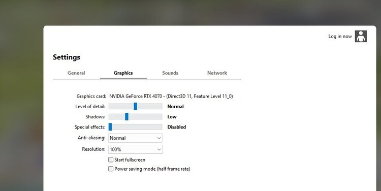

Neo Geschrieben 3. November 2024 Geschrieben 3. November 2024 Hi Peter, please post a screenshot of your V8.5 and V9 graphics settings. Kind regards, Neo
220hotwheels Geschrieben 3. November 2024 Autor Geschrieben 3. November 2024 14 minutes ago, Neo said: Hi Peter, please post a screenshot of your V8.5 and V9 graphics settings. Kind regards, Neo Hi Neo As requested I have attached screenshots of both graphic card settings. I have tried adjusting the settings in both from both "normal" and "Low" to both "Normal and Normal" to both "High and normal" but it made no difference at all. At the moment I am assuming that V9 will not cope well with the large file size 5600Mb in V8.5 to 5960MB in V9. The Nikolaus II demo layout that I am working on for Klaus, (Sualokink), is only 1000MB so has no fps issues. Kind regards Peter
Roter Brummer Geschrieben 3. November 2024 Geschrieben 3. November 2024 Hello Peter, your shadows are set higher in V9. HG Brummi
