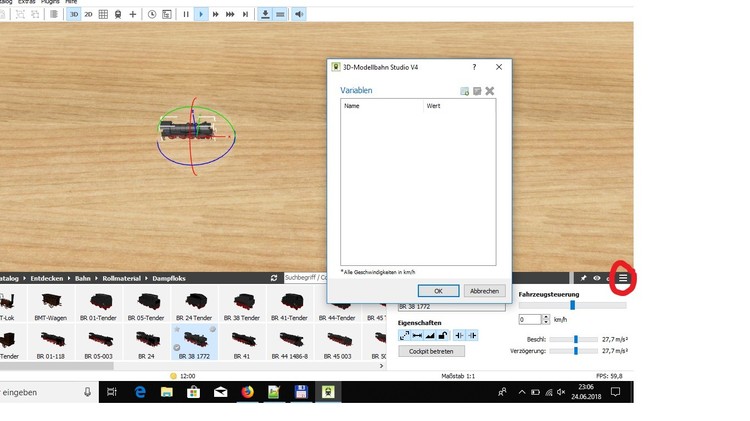

  3. Hello simon, not the event wizard, try the trains menu, look here:
  4. Hi simon! If you look close to the trains parameters, there's a symbol in the top row leading to 'object variables'. This is a field of variables to be defined local to the object. You may spent here a variable called (i.e.) standardspeed and set it (i.e.) to 100. Instead of setting a fix value for the trains speed when the signal turns green, you can now give the value mytrain.standardspeed, or even better, use _Trigger1 (or maybe 2), read the instructions for that special one. Another possibility: grab the invisible (read-only!) objectvariable mytrain._TargetSpeed and save it to another variable before setting the speed to zero. Don't forget the $-character before the variable's name to pick the real value and not the variable's name (strings and values are treated pretty same here). That's hopefully just a question of time. In the english section of the forum you may have to wait sometimes a bit to get a response - but someone will care! So far, everyone from everywhere is needed for further development. Best wishes for your project. Andy
