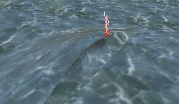

  14. simonjackson1964 hat Thema erstellt in Anlagen
    DUUUDE! Wave like that ya just gotta ride it! (The surfboard is two circles, back to back, 2.5m x 0.5m, coloured red and given a metallic texture).
