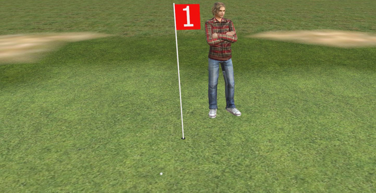

This is what I have so far...
The guy is just one of the standard figures The flag, pin, hole and ball are resized primitives, and the number is a label, that can (obviously) be edited. This was just a "test board", so there's no height variation, which would make the bunkers/sand traps look more realistic

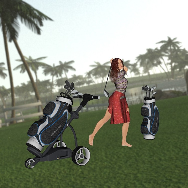

Here's my first golf bag ...
It is, however, 130,000 polygons, for now ..! I'll get reducing and see how it fares. There are plenty of hidden faces, so I'll start there.
Here is my first golf bag ... but
currently there are 130,000 polygons ..! I'll cut down and see how it fares. There are a lot of hidden faces so I'll start there.
Edit : The new bag has been 'decimated'; it's now 6500 polygons..! The Textures are still a little too big, and I need another Level Of Detail, but I think it'll be OK after that...

But it's so frustrating..! The System wants an LOD1 file, with no more than three materials. OK, I remove the two materials that won't be seen at a distance anyway, and re-present the result. No, no more than three materials; the System says it has four. I check; it has three. The System  insists it has four. I 'open' the Glb file and read it myself; it says 'three' (indexed 0, 1 and 2...). Why does MBS insist on finding four in there..? Is there a log file, telling me at least what these materials are..? How to proceed now..? The poly count is good, the material files are the right size, power of two, there are only three materials in the LOD1 version... I've attached a zip file with my two Golf Bags; the full-fat one and the LOD1, if there's someone able to enlighten me. It's so frustrating..!
Aber es ist so frustrierend ..! Das System möchte eine LOD1-Datei mit nicht mehr als drei Materialien. OK, ich entferne die beiden Materialien, die aus der Ferne sowieso nicht zu sehen sind, und präsentiere das Ergebnis erneut. Nein, nicht mehr als drei Materialien; Das System sagt, es hat vier. Ich überprüfe; es hat drei. Das System besteht darauf, dass es vier hat. Ich öffne die Glb-Datei und lese sie selbst. es heißt 'drei' (indiziert 0, 1 und 2 ...). Warum besteht MBS darauf, dort vier zu finden? Gibt es eine Protokolldatei, die mir zumindest sagt, was diese Materialien sind? Wie gehe ich jetzt vor? Die Polyanzahl ist gut, die Materialdateien haben die richtige Größe, Zweierpotenz, es gibt nur drei Materialien in der LOD1-Version ... Ich habe eine Zip-Datei mit meinen zwei Golftaschen angehängt; das Vollfett und das LOD1, wenn es jemanden gibt, der mich aufklären kann. Es ist so frustrierend..!

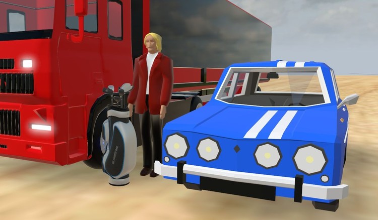

Personally I'm really impressed. I have no idea how you did that.
What I do know though is when I opened the LOD-1 versio, it opened itself in a program I have never used called "Windows 3D Builder" - where I was expecting to see it ask me to search for a program.
The program opened the .glb file, but gives a message: "One or more objects are invalidly defined. Click here to repair."
I "click here"and it "Repairs" it somehow that is beyond me.
I cal say without a doubt though that the bag and clubs are separate, so maybe it's the clubs that are causing the problem?
Bearbeiten: Die neue Tasche wurde "dezimiert"; es ist jetzt 6500 Polygone ..! Die Texturen sind immer noch etwas zu groß und ich brauche eine weitere Detailebene, aber ich denke, danach wird es in Ordnung sein ...

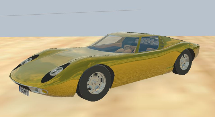

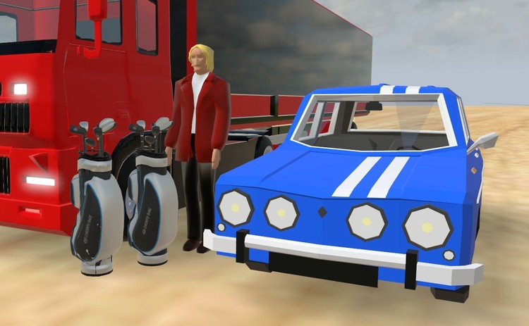

Oh and that's totally the wrong car...
This is the one:
Although I think an apology is owed to any Italians using 3MBS, as it's listed as a Lamburgini Miura, not a Lamborghini Miura. But there is just about room behind the engine for a set of golf clubs.
9_9

That's Windows for you, linking the file to whatever it thinks is right. Not too bad a guess, as it happens, as glb files are 3D, and 3D Builder works with 3D files. I use it for my 3D printer; it's very good. As for the 'repair', that often happens when using files from another programme (Blender, in this case...). This 3D malarkey is quite delicate, so it doesn't take much for one programme (3D Builder, in this case...) to take umbrage at the output of another (Blender...). It's not an issue, and I don't think it'll help me get this LOD1 file into MBS..! :)
Yes, the clubs are, technically, separate, but have no Material in this LOD1 version. I could remove them, I suppose, as they won't be seen at LOD1 level, anyway. Worth a try, but doesn't explain why MBS 'sees' four Materials when the glb file only has three.
How do I do it..? It's simple, really: I cheat. The lady and props come from Daz-3D, an excellent programme for 3D stuff. As I mentioned, my issue is not the subject, but how to get these items down to MBS size, whilst keeping enough quality. I'm pleased with the golf bag, down from 130,000 to 6000 poly's, and 3000 or so for the LOD1. It's my first time at honing down to this level, and is interesting (but frustrating..! >:()

Well, I got the golf bag files to load, with no errors, by deleting the clubs from the LOD version. Still no explanation for the number of materials, but one day I will understand.
I found that the definition LOD1 kicked in too early for this item, so I named it LOD2 instead, and it works better. To illustrate, I created a short Hollywoodian epic; a truck acts as a 'traveling' to move away from the bags. The right-most is the very high poly count (its high definition can be appreciated, but at what cost ..!), To its left is the 'real' bag. Left again is the LOD1, and that on the far left is the LOD2. As the camera moves away, at 10 s the LOD1 kicks in (no clubs visible ...), then at 50 s it's the turn of LOD2.

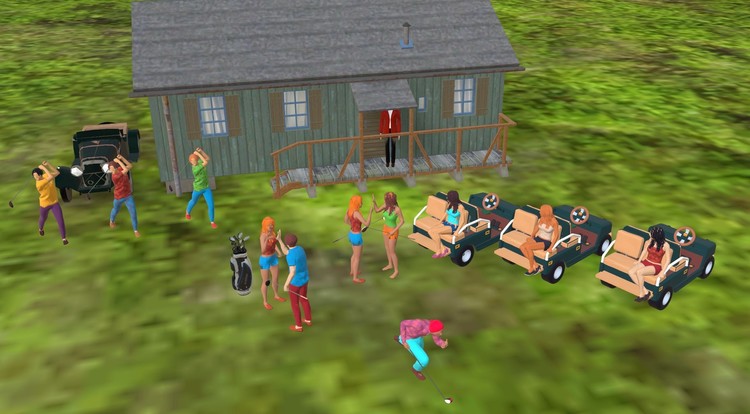

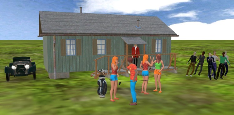

Here's a quick golf scene, with some newly-created golf people, celebrating their round. Two complete folks for now, a man and a girl doing a 'high-five'. The girl has an alternate colour scheme; the man doesn't, as yet, but I can do them now.
Questions...
How many alternative costumes would be reasonable..? They're not difficult, nor long to do. I would suggest maybe five for each person..?
How many different poses would be reasonable (for men and women...)..? I have about fifteen or twenty for each. I spent a couple of days working out how to do these, but now that I have the Method pretty much established, it's about an hour or so for each one. Is it a case of 'the more, the merrier'..?
Once I've done all of these (and the bags and carts; they've not been forgotten...), how would it be best to make them available..? The two characters presently done are ready to be presented for inspection. Would they each be available separately, or grouped into a 'golf' category or similar..?
Meanwhile, I'll continue preparing other people for this. It's very good practise for me, and I learn a lot in doing it. Thanks in advance for any suggestions and (kind...) criticism. Be gentle, however; I'm a beginner in all of this. :D
