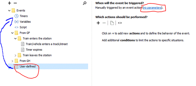

Hi Goetz,
The first situation, I already use it.
The second situation (different triggers), I"ll try asap.  Just to know :
  1. when I define the "user defined" event under the first Event definition, the new event is physically placed after all other existent events and I cannot move it up to be placed as the first one in the list.
  2. Parameters : may I, for example, give the name of a vekicle and use it as an object?
Thank you

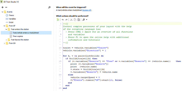

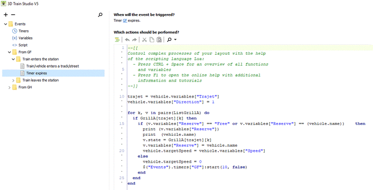

Hi Goetz,
I have another problem : Look at the 2 Lua scripts, one in the case "train enters track" and the 2nd whem "timer expires".  The first one works good, but the second one gives an error condition "script error (10) : attempt to index a nil value (global 'vehicle')".  Is it because, as in V4, the trigger in the case of "timer expires" points only to the timer's name?

Sorry, here are the 2 scripts
André
vor 13 Stunden schrieb ademes:
No, not quite.
But the timers, event variables and the event script come first.
Below that you may sort your modules (folders) and events in any order.

The error message
is exactly what it says: Your timer script doesn't know what vehicle you're talking about. There's "nil" vehicle stored in the variable "vehicle".
When an event is triggered by a vehicle, the triggering vehicle is automatically transferred to the variable "vehicle". But it (as all variables) is a local one, not known to other events. If this wasn't the case, you couldn't have different vehicles triggering different events at different locations.
The expiration of your timer is not triggered by a vehicle. So the variable "vehicle" doesn't exist here. You'll need to store the vehicle elsewhere and then access that storage (i.e. variable) in your timer function.
Having said that, a timer is not your best choice for a delayed vehicle command anyway. V5 offers a much better alternative:
Simply insert a delay command before the action.
The EV will take care of the rest and you don't have to bother with reacting to a timer expiring.
Bearbeitet von Goetz
spelling

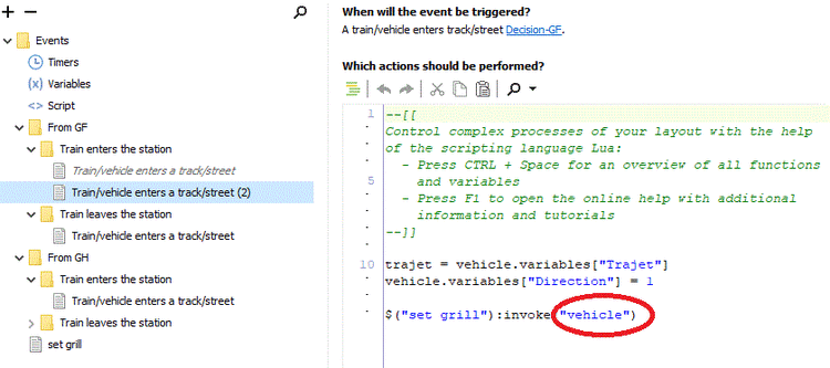

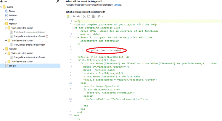

hello,
Here are the problems encountered when trying "user-defined" scripts.
  1. As one can see in the attached screens, I call the "user-defined" Grill giving only one parameter "vehicle" that is the trigger to the engine defined in the event "train enters track".  the parameter has been given the "object" as type.
    The called script execute only one instruction : print (vehicle.name) and this results in a print "Nothing" as seen on the event trace.
  2. It seems to be impossible to communicate a table to the called script.
Regards
André

vor 31 Minuten schrieb ademes:
You're wrongly passing on a string "vehicle" instead of the object vehicle, which is what you should do.
Try
$("set grill"):invoke(vehicle) -- no quotation marks around "vehicle"
example added

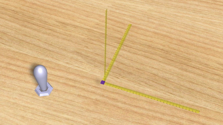

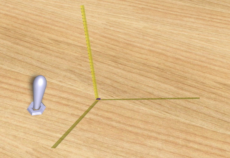

Hallo @Neo
Warum gibt das MBS bei der Abfrage der Rotation eines Objekes das Quaternion 0,0,0,-1 aus und nicht 0,0,0,1 ? (Bei 0° in allen Achsen).
Hintergrund: Bei meinen Versuchen mit der Rotation ist mir gestern ein Objekt im wahrsten Sinne des Wortes "in Nirwana" verschwunden.
Bei dem Versuch der Umwandlung einer Matrix in ein Quaternion hatte ich das Ergebnis 0,0,0,1 was eigentlich dem enspricht, was ich als 0° in alle Richtungen bezeichnen würde.
... also habe ich folgenden Versuch gemacht...
... ein Objekt irgendwie verdreht...
... und dem Schalter dies mit auf den Weg gegeben...
$("Lineal 1:1 30 m").transformation.rotation={0,0,0,1}
q=$("Lineal 1:1 30 m").transformation.rotation
print(q.x,q.y,q.z,q.w)
...wenn ich den Schalter betätige sieht es eigentlich ganz gut aus...
... das ausgelesene Quaternion sieht so aus...(???)
... und wenn ich den Schalter dann noch einmal betätige dann dies...
... das ausgelesene Quaternion ist ???????
... und das Objekt hat einen Quantenzustand angenommen...
... und ist aus diesem auch nicht wieder in die Realität zurückholbar...
Quaternion01.mbp
... wenn ich also das Objekt in der Rotation zurücksetzen möchte muß ich...
$("Lineal 1:1 30 m").transformation.rotation={0,0,0,-1}
... zuweisen... warum???
Bearbeitet von EASY
Nach den Quaternion-Regeln gilt: (es heißt übrigens wohl tatsächlich die Quaternion! (w!))
aus x,y,z,w wird:
der Winkel um den gedreht wird:
alpha = 2*acos(w)
mit der Rotationsachse:
b=x/sin(alpha/2)
c=y/sin(alpha/2)
d=z/sin(alpha/2)
Einheitsquat x=0,y=0,z=0,w=-1
alpha = 2*acos(w) = 2*acos(-1) = PI (in Radian)! => entspricht 360°, aber mit w=1 wäre das Resultat 0
es gilt für die Rotationsachse:
b=x/sin(alpha/2)  -> b=x
c=y/sin(alpha/2)  -> c=y
d=z/sin(alpha/2)  -> d=z
-> b,c,d = 0
dreht also um den Vektor (b=0,c=0,d=0) alpha.
Wenn hier alpha mit 0 eingesetzt werden würde, wird sin(0)=0. Steht im Nenner -> PENG!
Eigentlich wird um 360° gedreht, sonst knallt's im Nenner.  sin(PI/2) = 1  sin(0) = 0
Bei den Drift-Versuchen habe ich resultierende Winkel mehrfach in den Range -180 ... +180 rein zwingen müssen, sonst hätte es auch geknallt.

vor 15 Stunden schrieb EASY:
Das hat etwas mit den internen Abläufen zu tun. Intern nutzt das Studio ein linkshändisches Koordinatensystem (DirectX Standard), nach Außen hin (Gizmo, Transformationsseite, Lua...) nutzt es ein rechtshändisches System. Durch die Konvertierung dreht sich das Vorzeichen um. Das ist aber nicht wichtig, weil eine Rotation um 0° oder um 360° zum gleichen Ergebnis führt.
Du verwendest hier eine falsche Tabelle. Korrekt müsste es lauten:
$("Lineal 1:1 30 m").transformation.rotation={x=0, y=0, z=0, w=1}
Durch die falsche Tabelle wird intern die Quaternion auf 0 gesetzt, was ein ungültiger Zustand ist. Dass dein Lineal noch korrekt positioniert wird ist nur ein glücklicher Zufall, die Rotation ist dann aber schon kaputt (deshalb die anschließenden NaNs).
vor 11 Minuten schrieb Neo:
Man muß halt nur bei Winkelspielereien aufpassen. Die Hälfte von 0 bleibt 0, die Hälfte von 360 ist 180.
vor 12 Minuten schrieb Neo:
Um ehrlich zu sein finde ich das richtig so. Solche Kulissen gibt es auch auf echten Modellbahnen, dort fallen auch Schatten auf die Wände.
Das nenne ich ein Argument :)
vor 12 Minuten schrieb Andy:
von solchen Spielereien würde ich Abstand nehmen, für gewöhnlich braucht es keine Winkelumrechnungen, um mit Rotationen zu arbeiten.
Ich werde die Ausgabe beim nächsten Update in die Normalform bringen, d.h. bei negativen w wird die Quaternion negiert, sodass bei keiner Rotation (0, 0, 0, 1) in Lua zurückgegeben wird (q = -q).
