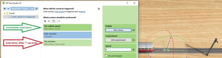

ademes Geschrieben 29. August 2019 Geschrieben 29. August 2019 the question is : does the delay trigger the event in whitch it is initiated once again? In other words, does the event restart automatically after the delay? Thank you André
Goetz Geschrieben 29. August 2019 Geschrieben 29. August 2019 (bearbeitet) vor 13 Minuten schrieb ademes: does the delay trigger the event in whitch it is initiated once again? No. It delays all actions that you enter below that command. Bearbeitet 29. August 2019 von Goetz
metallix Geschrieben 29. August 2019 Geschrieben 29. August 2019 (bearbeitet) vor 3 Stunden schrieb ademes: hello, I have a question concerning the "delay command" Hi "Delay" is not necessarily the right word to understand the power of this. "Pause" might describe it better. The event is paused until the specified time is up, thereafter every action below it is executed. As I discovered, deferred execution behaves a bit different to timers by still kicking in action after the event, they are part of, got re-activated, if the initialising event is triggered while they deactivated. So if this (the initialisation during deactivation of the deferred execution event) happens in short sequences one can get the impression it is self-triggering. Cheers Tom Bearbeitet 29. August 2019 von metallix
Goetz Geschrieben 29. August 2019 Geschrieben 29. August 2019 vor 10 Minuten schrieb metallix: would you like to share it? He did, Tom. And he got his answer too. A fair three hours ago ... But you're right, nevertheless: the split into two postings was misleading. More so because they happened to be placed on two different pages.
metallix Geschrieben 29. August 2019 Geschrieben 29. August 2019 Hi Goetz Yep, I only noticed after posting this reply. Unfortunately, the pages rolled over between the announcement and the actual question, and I was assuming being already at the end of the thread. Never mind, I dumped that initial comment and rather added some of my mustard to the subject Cheers Tom

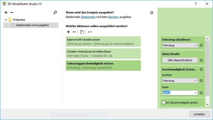

Roter Brummer Geschrieben 30. August 2019 Geschrieben 30. August 2019 (bearbeitet) Hallo Neo, noch ein Problem: Zug X betritt Gleis Y Regler Z soll Geschwindigkeit von Zug X übernehmen auf Gleis Y übernehmen. Wie krieg ich das hin? HG Brummi Edit: Im Moment zwingt Regler Z dem Zug X die am Regler eingestellte Geschwindigkeit auf. Bearbeitet 30. August 2019 von Roter Brummer
Goetz Geschrieben 30. August 2019 Geschrieben 30. August 2019 (bearbeitet) vor 26 Minuten schrieb Roter Brummer: Wie krieg ich das hin? eine Vermutung (die ich noch ausprobieren muss) ..: Du kannst zuerst die Geschwindigkeit der Lok auslesen und auf die Reglerstellung übertragen. Da die Maximalgeschwindigkeit 330 beträgt und die höchste Reglerstellung 100 (Prozent) würde ich versuchsweise die Geschwindigkeit durch 3,3 teilen um die passende Reglerstellung zu bekommen. Anschließend (und im selben Ereignis!) würde ich dann den Regler der Lok zuweisen. Denkste! Dem Regler kann ich keine Stellung zuweisen. Der soll wohl per definitionem steuern und nicht gesteuert werden ..? Aber so geht es: Geschwindigkeit der Lok speichern, Regler verbinden, Geschwindigkeit aus der Variablen wiederherstellen. Bearbeitet 30. August 2019 von Goetz

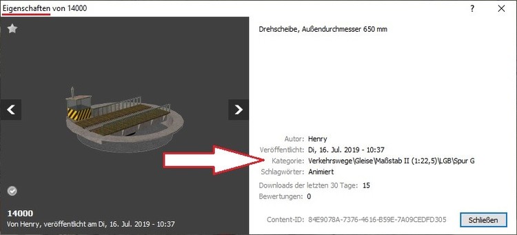

Berlioz Geschrieben 1. September 2019 Geschrieben 1. September 2019 Hallo, entschuldigt bitte, wenn meine Probleme hier vielleicht schon erwähnt wurden, aber beim Überfliegen der 18 Seiten kann mir auch was durch die Lappen gegangen sein. In der Suchoption erscheinen so viele schöne Drehscheiben. Unter Bahnbetriebswerk sind die bei mir nicht zu finden. Leider finde ich den richtigen Pfad nicht. Das wär jetzt nicht das Problem, aber vielleicht sehe ja auch viele andere tolle Modelle nicht. Wenn ich aus größerer Höhe größere Objekte über den Modelleditor verändern möchte, baut der sich nur sehr langsam bis gar nicht auf, oder ich kann die Felder der Maske nicht anklicken. wenn ich optisch nah am Objekt bin hab ich keine Probleme damit. Viele Grüße, Berlioz
Timba Geschrieben 9. September 2019 Geschrieben 9. September 2019 Am 1.9.2019 um 05:06 schrieb metallix: Und hier ein sehr unschoenes verhalten von zwei timern, welche ... Meines Erachtens ein nutzerseitiges Problem. Habe das Beispiel auf einem kleinen Brett, bestehnd aus nur 1 Stück Gleis, 1 Lok und ein GK, ausprobiert. Funktioniert genau wie es soll. Ist ein Ereignis deaktiviert, wird der betreffende Timer nicht gestartet. Beide Varianten getestet. Einwandfrei!
Goetz Geschrieben 9. September 2019 Geschrieben 9. September 2019 Am 1.9.2019 um 19:34 schrieb Berlioz: In der Suchoption erscheinen so viele schöne Drehscheiben. Mit einem Rechtsklick auf solch ein Modell kannst du die Eigenschaften öffnen. Dort findest du, wo das Modell einsortiert wurde. Drehscheiben sind oft in den Gleissystemen zu finden, weil sie dem Sortiment von Gleisherstellern entstammen. Am 1.9.2019 um 19:34 schrieb Berlioz: Wenn ich aus größerer Höhe größere Objekte über den Modelleditor verändern möchte, baut der sich nur sehr langsam bis gar nicht auf Aus großer Höhe hast du auch viel mehr Modelle in deinem Blickfeld. Also hat die Grafikkarte deutlich mehr Arbeit.
