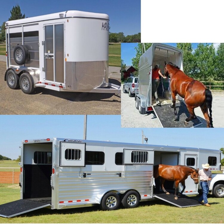

    Allthough variations are welcome. Not only in size, but in texture also. (my 2 cents) And then there is this... (i think i have mentioned it somewhere) Innumerous options to make something with horses as the centre subject. with kind regards.
