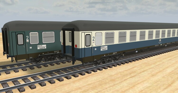

1 hour ago, Roter Brummer said:
Also Douglas,
but now i'm stinky too. Three measurements are given on the drawing. I would have to measure them now and convert them to the window width and the gaps using the rule of three. You can do that too, can't you?
Another approach: You place the drawing as a semi-transparent layer over your image. Then you know where the windows belong.
I understand that, even without translation, sarcasm is very poorly portrayed in emails and messages. I deliberately refrain from such posts. Thanks for the drawing; yes, I am able to work out dimensions from it, to a certain degree of precision. Is it enough..? I hope so...

Ist es möglich uns eine Datei zur Verfügung zu stellen, in der nur dieses eine von dir zuletzt gezeigte Modell enthalten ist?
Is it possible to provide us with a file containing only this one model you showed last?

12 minutes ago, Roter Brummer said:
Is it possible to provide us with a file that only contains the last model you showed?
Yes; I'll add the LOD2 and post it as a Draft. It won't have the Emissive texture until everyone is happy with the windows, though.
Yes; I will add the LOD2 and post as a draft. However, it won't have the Emissive texture until everyone is happy with the windows.

Hello Douglas,
Your test of the green 2nd class coach is the best possible result on which the majority of participants in our long discussion should be able to agree. That's at least what I think.

Hallo Douglas,
der Wagen sieht jetzt gut aus. Ich schlage vor, noch einige Änderungen im Bereich der Türen vorzunehmen.
the car looks good now. I suggest to make some more changes in the area of the doors.
Die Türen sind insgesamt kleiner und der Abstand zwischen Tür und erstem Fenster ist etwas größer. Dort ist dann die Klassenbezeichnung und einige andere Hinweise.
Durch die gesamte Textur der Seitenwand läuft ein heller Strich. Der gehört dort nicht hin und ist wahrscheinlich bei der Bearbeitung der Grafik entstanden. Bei den Fensterrahmen würde ich mir mehr Trennschärfe wünschen.
The doors are smaller overall and the distance between the door and the first window is slightly larger. There is then the class name and some other clues.
There is a light line running through the entire texture of the side wall. It doesn't belong there and was probably created when editing the graphic. I would like to see more sharpness in the window frames.

ich habe mir ein paar Gedanken darüber gemacht, wie die Tauschtextur prinzipiell aufgebaut sein müsste.
I've been thinking a bit about how the exchange texture should be structured in principle.
  1. Die Wagen haben ausnahmslos Übersetzfenster. Es gibt also die beiden charakteristischen Handgriffe oben und die Fensterteilung in der Mitte.
  2. Die Drehfalttüren liegen nah am Wagenende, aber so dass sich das große Türelement oberhalb der Trittstufe befindet.
  3. Die Wagenklasse befindet sich zwischen Tür und erstem Fenster.
  4. Darunter sind (waren) die Raucherpiktogramme.
  5. Die Türöffner sind normale Klinken. Hier müsste die Textur noch dahingehend geändert werden, dass die eigentliche Klinke im geschlossenen schräg nach oben zeigt.
  6. Neben der Tür ist in Richtung Wagenmitte eine Griffstange angebracht.
  7. Daneben befindet sich der Halter für die Wagennummer und der Halter für das Zuglaufschild.
  8. Das jeweils erste Fenster gehört, diagonal versetzt, zur Toilette und ist deshalb mit Milchglas versehen.
  9. Das Bahn-Logo ist meistens genau in der Mitte des Wagenkastens. Darunter befindet sich die Computer-Nummer des Wagens. Bei den Pop-Lackierungen ist das Logo zu den Einstiegen hin verschoben.
  1. The cars have translation windows without exception. So there are the two characteristic handles at the top and the window division in the middle.
  2. The revolving-folding doors are close to the end of the car, but so that the large door element is above the step.
  3. The carriage class is located between the door and the first window.
  4. Below that are (were) the smoking pictograms.
  5. The door openers are normal handles. Here, the texture would still have to be changed so that the actual handle points diagonally upwards when closed.
  6. Next to the door, in the direction of the center of the car, is a handle bar.
  7. Next to it is the holder for the car number and the holder for the train running sign.
  8. The first window in each case belongs, diagonally offset, to the toilet and is therefore provided with frosted glass.
  9. The railroad logo is usually right in the middle of the car body. Below it is the computer number of the car. On the pop liveries, the logo is shifted towards the entrances.
Es empfiehlt sich, eine Grafik mit vier Layern vorzuhalten. Der unterste Layer beinhaltet die Grundfarben des Wagenkastens und die unveränderbaren Teile. Die anderen Layer fügen das Fensterband, die Beschriftung und die Schlussleuchten hinzu. Die Erstellung der Layer hat ziemlich viel Zeit gekostet, aber so sind die Farbvarianten schnell und vor allem problemlos und absolut trennscharf erstellt.
It is recommended to have a graphic with four layers. The lowest layer contains the basic colors of the car body and the unchangeable parts. The other layers add the window band, the lettering and the tail lights. Creating the layers took quite a bit of time, but this way the color variants are created quickly and, above all, without any problems and with absolute separation.
