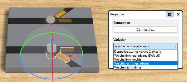

  4. Hello Stephen, yes, they do. You may want to check the variants of the button to select the appropriate one for either a left or a right turnout. Kind regards Goetz
