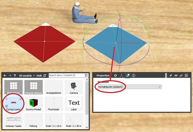

  12. Frankly, I don't know. But by use of a contact from the extras menu and changing the contact's properties to "static" I mangaged to figure it out when I dragged the driver onto that blue contact:
