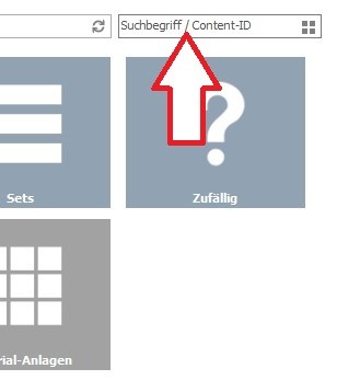

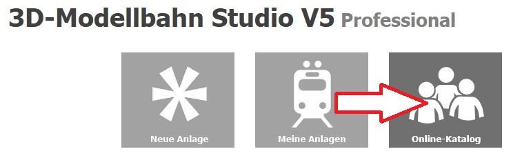

  4. it's not a model ID It's the ID of a layout. Hence, you need to search for it on the starting page. Please, click on "Online Catalog", then enter the id in the input field at the top right
