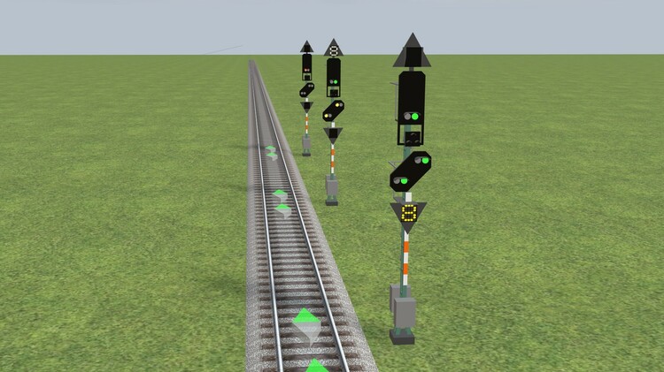

  4. The difference being, that the lines into London have their signals so close together, that you need multiple signal distances to slow down from line speed to stop. With the 69 System that is not the case. You have enough space between each signal to stop from line speed. Even in areas where such a progression system is used, it is purely done to get a more regular flow of trains. Purely for technical reasons with the PZB safetsystem you have to put signals in certain distances to each other for it to work correctly.
  5. So, now that i had the time: This is what your down progression would look like. The first signal gets approached at linespeed 120km/h, tells the driver to slow down to 80km bevor the next signal. The second signal gets approached at 80km/h, tells the driver to limit his speed to 80km/h and the red distant tells him to slow down to below 40km/h or drive on sight (what ever is lower depending on track visibility) BUT: The distance between each of those signals is enough for the train to stop from linespeed bevor the next signal. Usually 1km. Such setup is rare and only used on lines with very high amounts of trains to get them moving along a bit more fluent. Like between a mergepoint of multiple lines and a big station, when there aren't enough running lines. OR: They use the more modern Ks-System, but that works quite different from the 69-system. Regards Sintbert
  6. Not at all.. It is not based in progression like the UK signaling. The Basic Signal is just Green/Red. And the basic signaling is just: G G R | | | ------------... Then you have the distant signal: G G R G R - | | | -------------- The ZS3 only gives the current signal a different speedlimit from the trackspeed or displayed speed And the ZS3V only shows what the ZS3 on the next signal shows. It is always only the state of the current signal, showed by the mainsignal and ZS3, and below the state of the next signal, showed by the distant and ZS3V. Anything different from Green/Red was originally only shown, when a turnout has a lower than linespeed limit. Example: for strait, its green, for turnout its green&yellow (40km/h). Then the ZS3 can be used when the turnout allows as example 60km/h. The Signal would show green&yellow and the ZS3 6 for 60km/h instead of the signaled 40km/h
  7. That is wrong. The ZS3 together with the signal shows what ist to do at the current location. The ZS3v together with the distantsignal shows what is to do at the next signal location. Usually the distant is in braking distance to its mainsignal on linespeed. Trains that cant satisfy this requirement have to drive at lower speeds. ZS3 ist often not used to slow down the train to a stop, but to give a speedlimit for turnouts. A gradual slowdown is only required when you don't have braking distance between signal. When you want to realize a gradual slowdown from lets say 160km/h then i would do something like this: 1. Mainsignal green, ZS3 dark, distant green, ZS3v showing 12 - Driver will start to slow down to 120km/h for the next signal. 2. Mainsignal green, ZS3 showing 12, distant red, ZS3v dark- Driver will slow down to below 80km/h within 20s to satisfy PZB, then continue to slow down, prepared to stop on next signal. 3. Mainsignal red, ZS3 dark, distant dark, ZS3v dark- Driver stops ahead of signal. Even more gradual would be: 1. Mainsignal green, ZS3 dark, distant green, ZS3v showing 12 - Driver will start to slow down to 120km/h for the next signal. 2. Mainsignal green, ZS3 showing 12, distant green, ZS3v 8 - Driver will slow down to below 80km/h within 20s to satisfy PZB. 3. Mainsignal green, ZS3 showing 8, distant red, ZS3v dark - Driver will slow down, prepared to stop on next signal. 3. Mainsignal red, ZS3 dark, distant dark, ZS3v dark- Driver stops ahead of signal. I hope this helps. Regards Sintbert
