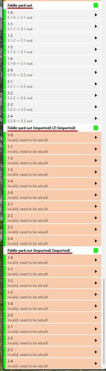

I can imagine where the problem lies. With routes, you have to be very careful to only activate them once and not (accidentally) multiple times. If you have set the defer request option (see picture), the program puts all requests on a stack and processes then stack. This has (supposedly) strange consequences. The routes work absolutely flawlessly if you use them correctly. Kind regards Phrontistes -
