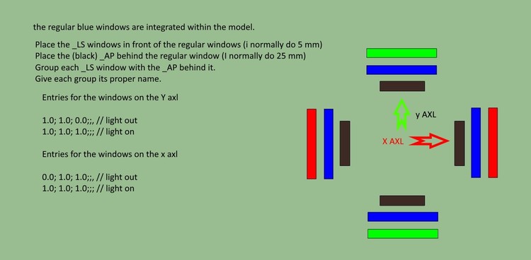

I have just send you a PN with some suggestions and the remark that the lights werent working.
But they do. (but inverted)
I have noticed that you have animated the windows to the sides.. My suggestion is to animate only the LS windows and then forwards and backwards.
Place the _LS windows in front of the regular ones and its _AP point behind the regular window > 20 mm will do fine.
So these regular windows can stay directly in the model, without animation (and no group or no AP needed for this)
In the X-file the entries should be then
000; 0.0; 1.0; 0;0;;,  (the first or last you can leave on 1.0 depending on what axl you going to scale the window < this depends on what axl the window is placed)
001;  1.0; 1.0; 1.0;;;
And so on for the other 2 animations
002-003 + 004-005
Now the _LS windows on position 0 in the animation will be behind the regular windows because the _AP is there.
On position 1 the windows go back to the position where you have placed them in the SKP file (in front) and they will be lit.
This way you dont need to animate the regular windows. The windows to lit will pop up in front of the regular ones.
Two mm diference is enough in the SKP file.
Many greetings.
Hubert
(edited; on second thought i have made a quick schedule here)

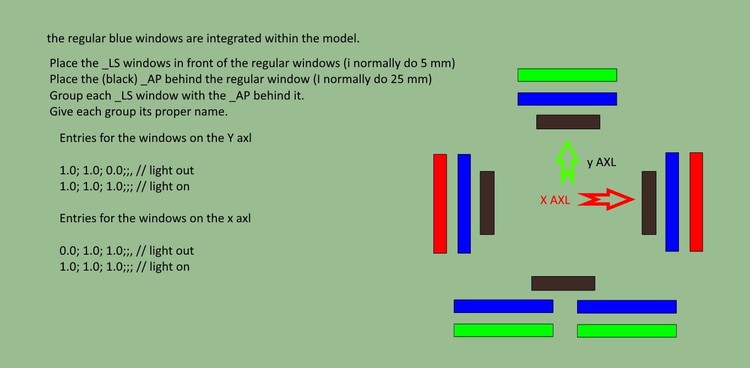

Just for the info; If you have two windows next to eachother, it could be like on this picture. One _AP for two (or more) windows. Even if they are on a different height. This way you can light up diferent rooms on diferent floors.
