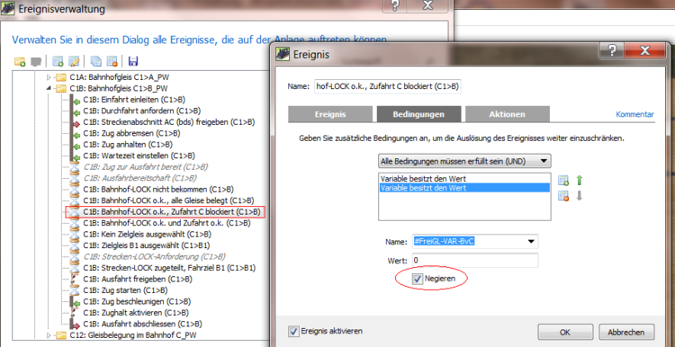

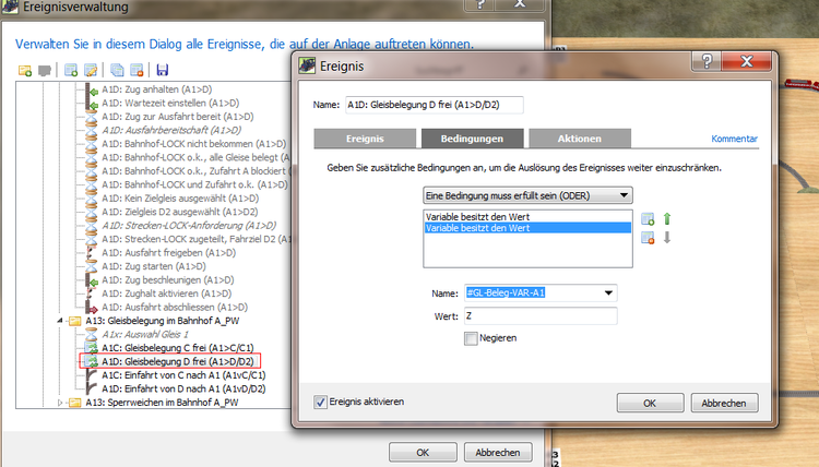

  20. Hello Trevor and Curt, within the event control handling, there are some actions which allow to assign a text content, e.g. "Set Variable". Here the $ sign is used to distinguish between the variable name and the variable content as shown in the following example: Let "VariableContent" be the content of the Variable named "OldVariable". Let "NewVariable" the name of the variable to which "Oldvariable" will be assigned. If you assign NewVariable = OldVariable, the content of NewVariable is "OldVariable". If you assign NewVariable = $OldVariable, the content of NewVariable is "VariableContent". You can test with the following example: Assign Variable Name or Content.mbp Click to the switch to turn it on or off. Consider also the implemented event control. See also the Wiki: Einige Felder erlauben sowohl die Angabe von konkreten Zahlen oder Zeichenketten, wie auch den Namen einer Variable (wie z.B. die benutzerdefinierte Objektauswahl oder das Setzen von Beschriftungen). Fügen Sie bei der Angabe von Variablen ein Dollarzeichen ($) vor den Namen ein, um dem 3D-Modellbahn Studio zu verdeutlichen, dass es sich bei der folgenden Zeichenkette um den Namen einer Variable handelt, und nicht um den tatsächlichen Wert. Many greetings BahnLand
  21. Hello Curt, thank you very much for uploading your layout here. I have studied your event control realization, and you are right: As long as there is no concurrency between different trains, it should work. But it isn't upgradable for use with concurrent train activities. Many greetings BahnLand

  24. Hello Curt, you cannot use a "common event definition" like a procedure from a programming language (e.g.Basic, C++, Pascal, ...), using a variable as container for a parameter. While the procedure provides parameters, where the caller can specify his current values to be used for this specific call (another possibly simultaneous call of this procedure can store and execute its specific parameters), the variable used instead within the event control of the TrainStudio is global and gets overwritten by each call of the common event routine. Assuming, that 2 calls of this event routine are realized quite simultaneously, the 2nd call will overwrite the parameter variable content of the 1st call, so that the 1st call will fail. To avoid such overlapping, you must lock the sequence consisting of the parameter variable overwriting and the common event routine call. But this seems more expensive than a multiplication of the event routine each using its own (fix) parameter values. Many greetings BahnLand Es ist nicht möglich, eine "gemeinsame Ereignisdefinition" wie eine in Basic, C++, Pascal oder einer anderen Programmiersprache geschriebene Prozedur zu verwenden, indem man anstelle der Programm-Parameter eine Variable des Modellbahn-Studios als Parameter-Container heranzieht. Während die Prozedur Parameter anbietet, die beim Aufruf mit aktuellen Werten versorgt werden können, und dann bei jedem Prozedur-Aufruf (auch möglicherweise parallel) lokal hinterlegt und abgearbeitet werden, wir eine stattdessen als Parameter-Container verwendete Variable vor jedem Aufruf der "Ereignis-Routine" (Ablauf der Ereignisdefinitions-Folge) überschrieben. Werden nun zwei solche Aufrufe nahezu zeitglich abgesetzt, wird die Variablen-Eingabe des 1. Aufrufs durch jene des 2. Aufrufs überschrieben, sodass der 1. Aufruf zwangsläufig zu einem Fehler führt. Um solche Überlappungen zu vermeiden, müsste man dann das Beschreiben der Variable zusammen mit der Ausführung der Ereignis-Routine durch einen Lock schützen, wodurch die Realisierung dieser Methode vermutich aufwendiger wird, als wenn die Ereignis-Routine für jeden Anwendungsfall einfach vervielfältigt und jeweils mit den spezifischen "fest eingebrannten" Parametern zum Ablauf gebracht wird. Viele Grüße BahnLand
