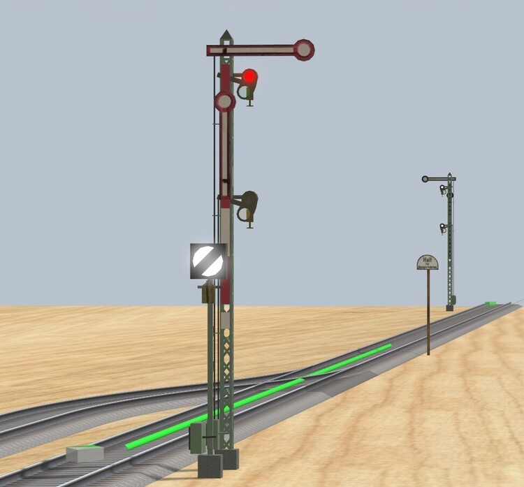

  1. nope! Hp2 is a "clear" condition with a speed limit (mostly, but not exclusively 40 km/h) No signal ever shows "clear" unless the guarded section is clear of any obstacles protected against any traffic from other directions (i.e. all other signals are set to HP00 reserved for a train entering the section from this signal with all switch points set correctly The default position of your signals is Hp00.
  2. Hello Simon, the two marked signals in your screenshot must (to all my knowledge) display HP00. That is always the case when tracks join. Maximum protection is required at such spots because of the risk of trains coming in on the other branch. Hp0 is sufficient when there's no danger from traffic coming from the side. Block separation is a classic situation for Hp0, because the only concern here is a train in front of you occupying the stretch of track after the signal. A station entry may also use Hp0, when the incoming track only fans out into many. Here too, your only concern is what lies ahead. Sh1 allows a maximum speed of 25 km/h They are the wrong choice for any station entry, regardless if the station is for passengers or freight and if you consider entering the station a shunting operation. Sh1 is used where you want to exit a section within a station. The Sh signals divide station areas into many small sections. Again, this is from what I learned while playing with the Studio. I'm not a train driver, nor an expert on signals by any other definition. Kind regards Goetz
  3. Use the pin to fix them permanently. This can be done individually for the simulation and the planning mode.
  4. You're mistaken on the second statement. Well, sort of ... This is what I learned from playing with the Studio and reading the odd posting in forums. There may be exceptions to my claims, but this is the gist of it: The HP signal protects the main line all the way to the next station or another Hp signal (for block separation), whereas the Sh signal protects the rail section immediately thereafter, only up to a marked point in close vicinity (or a followup Sh signal). The zone that's protected by the Sh signal doesn't reach that far. Never past any Hp signal except the one at the same spot. Sh (for Schutzhalt, i.e. protective stop) is a local signal, whereas Hp signals are for the journey to the next destination. Shunting is (in this context) always a local operation. Sh0 supercedes any HP signal, because you cannot enter the main line when the section immediately after the signal is inaccessible. But Sh1 doesn't override HP0, because it grants access only to a short stretch of track, nowhere near the end of the block that is protected by the Hp signal. On a type 69 light signal, you won't see any Sh indicator when it displays Hp1 and above. Only when the HP part shows stop (Hp0), will the Sh element indicate if a local shunt move is allowed or not. When shunting is prohibited too, this combination is labelled Hp00 and indicated by two red lights. When you have an entry signal for the oncoming traffic, the Sh zone will end before that. This is to protect any shunting operation from oncoming traffic. The picture shows a compressed mockup: I hope my English wasn't to quirky this time of night :-D Kind regards Goetz
