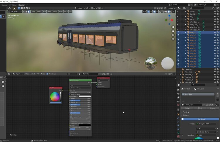

  3. Good evening ... I couldn't get on very well with SketchUp, despite having had excellent help and advice from members here (it's not their fault; it's just the way I see things ...). Blender has made more 'sense' to me, although it has far more features than merely those required for train models. I found a train I wanted to use as a test piece; in order to use scale, I found it useful to set the Units as in the screenshot below (outlined in pink ...), and used the Scale function (also outlined ...) to have exact measurements to work to. Disclaimer: I am not the originator of this loco, I simply adapted it from SketchUp to Blender (which was not easy, but taught me much ...). Here's the screenshot; hope it helps ... I didn't get along very well with SketchUp, although I got excellent help and advice from the members here (it's not their fault, I just see things that way ...). Blender has made "more sense" for me, even though it has far more functions than just those required for train models. I found a train that I wanted to use as a test piece; To use the scale I found it useful to set the units as in the screenshot below (outlined in pink ...) and used the scale function (outlined too ...) to get accurate measurements. Disclaimer: I'm not the author of this locomotive, I just adapted it from SketchUp to Blender (which wasn't easy, but taught me a lot ...). Here is the screenshot; I hope it helps ...

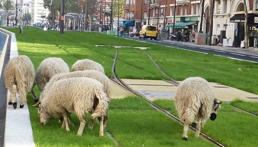

    In Nantes (France ...) there are many sections like this ... In Nantes (France ...) there are many such sections
